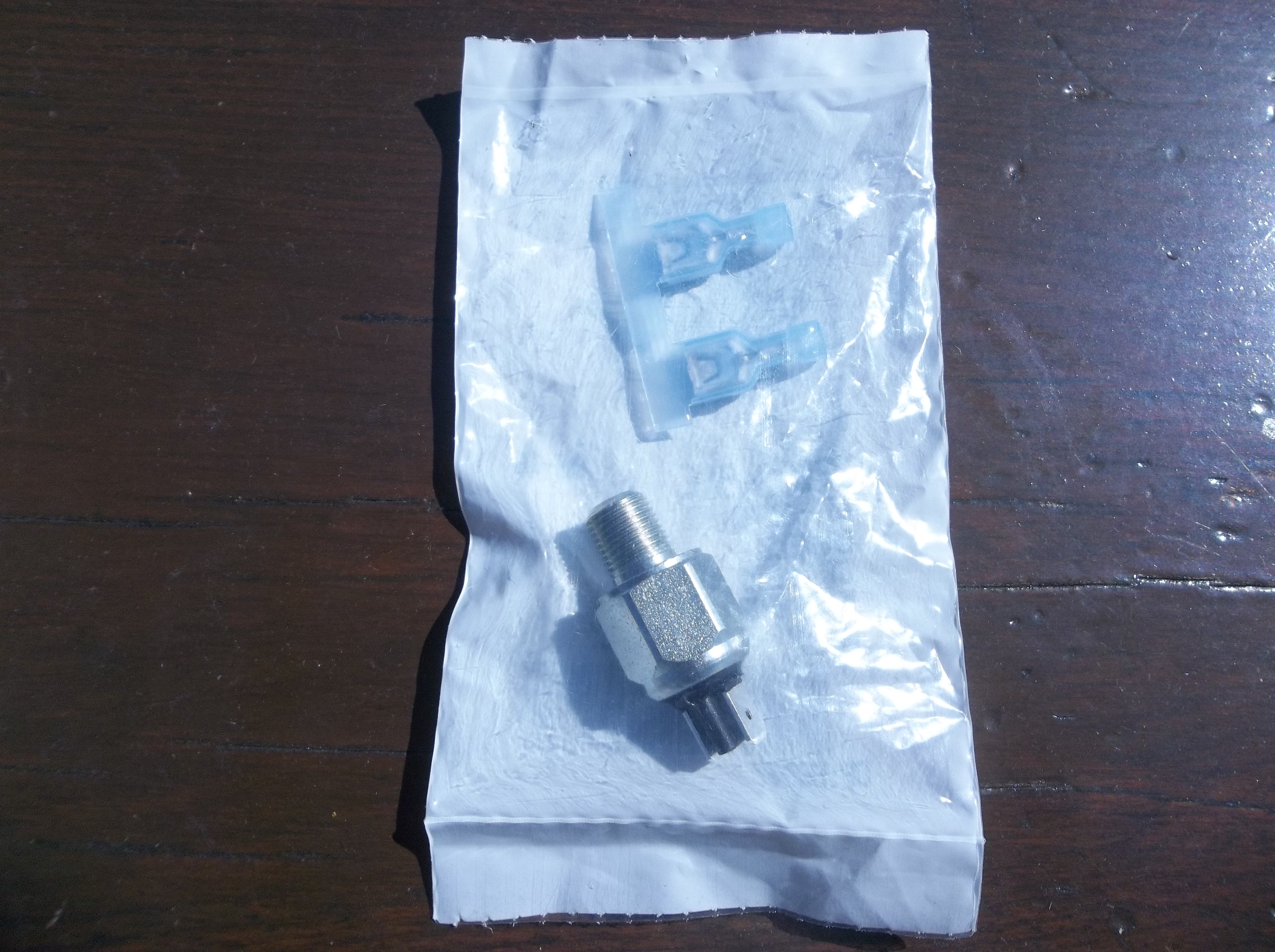

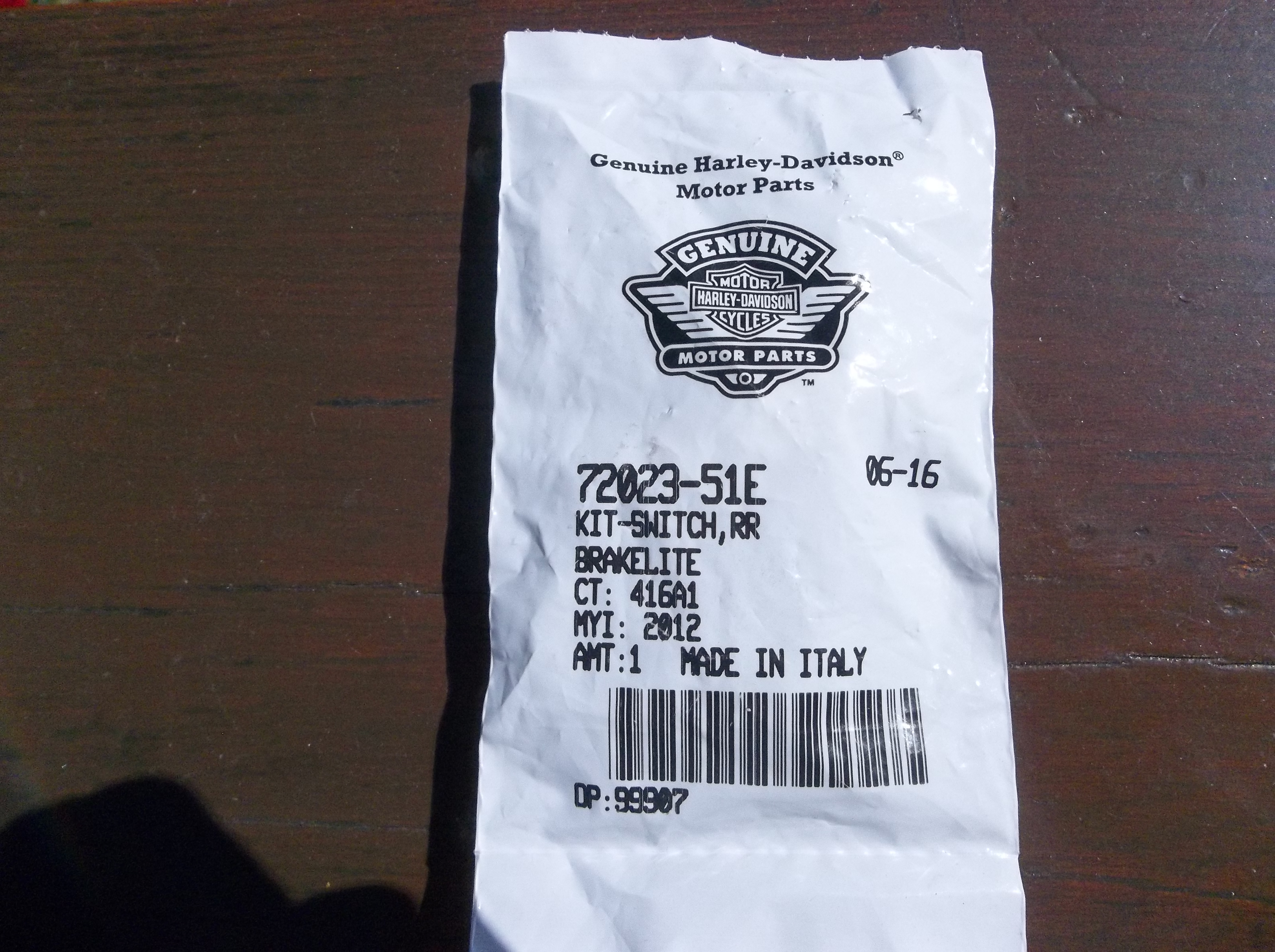

Grant | -- 05-31-2017 @ 5:49 AM |
Photo of Harley Davidson 72023-51E brake light switch. Definitely works very well with the hydraulic brakes on our '36.
Grant | -- 05-31-2017 @ 5:52 AM |
Second photo ............ other side of package ............ see-through clear plastic ............ shows switch and spade connectors which are included ...........
