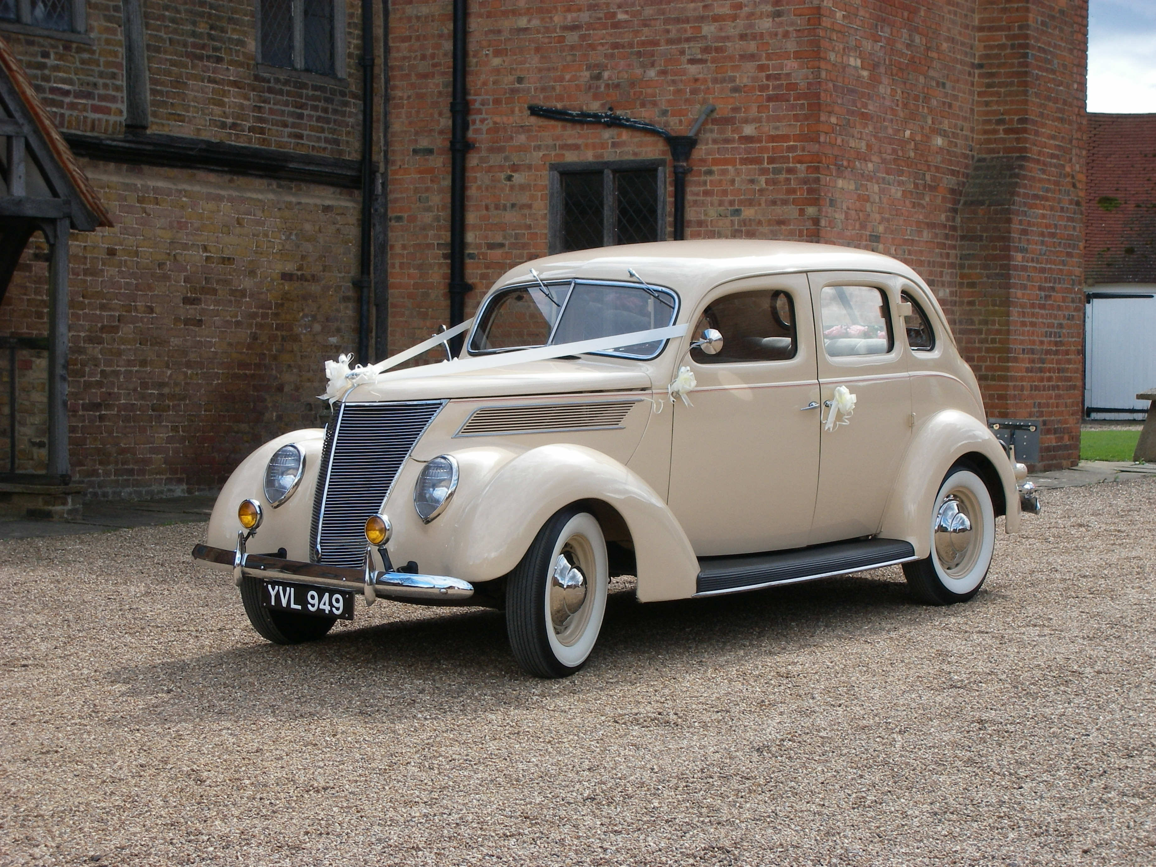

Hi I have a 37 model 78 Ford, it has 10 1/4" stud brake drums, they have been turned out past the max limit, does anybody know of a company in the USA of the rest of the world that manufacture new drums for this model, i live in the UK and not haveing a lot of luck, i am also trying to find a company that could put a sleeve in them, i would be intrested to see what others are doing. Regards Richard

Hi Richard, I see no reason why you can't use V8 Pilot Brake Drums which would be fairly easy to find here in the UK. I know that these will fit a 1937/8 Lincoln-Zephyr and in theory should fit a 1937/8 Ford, Your photo shows the car on correct 68-1015-A wheels with Pilot hubcaps. If it helps I can probably find some drums to measure. Are you a member of the EFV8 UK Group? Colin
