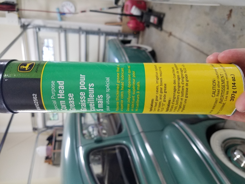

See attached. This is the stuff - at your local John Deere dealer. You'll find this referenced several times when searching on this Forum as well. Steve This message was edited by len47merc on 5-23-17 @ 7:34 AM

I agree with the advice given - JD cornhead grease is the tone to use in my opinion. Mike "Kube" Kubarth

The original Soda Soap grease is no longer made or available. Ford specifically pointed out not to use regular grease, since the rotating joint would throw off the grease and then become un-lubed. Many feel Corn Head grease is the answer. The corn head grease has to remain in contact with the rotating joint to turn to a liquid so you have to pack the entire joint clam sh*ll. If you want something that recombines and lubes, I use 0-0 grease. I put in what Ford suggest 4OZ through the speedometer turtle hole.
