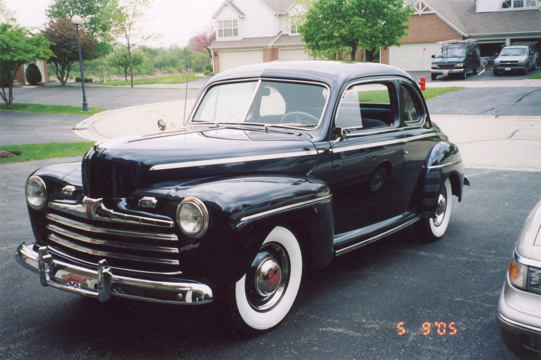

Attached is a pic of my car. I change the oil every summer and it has never burned oil - always near the full mark.

Hey there, Enjoyed the picture of your car. I have its twin. I agree with the others on letting us know what happens.
