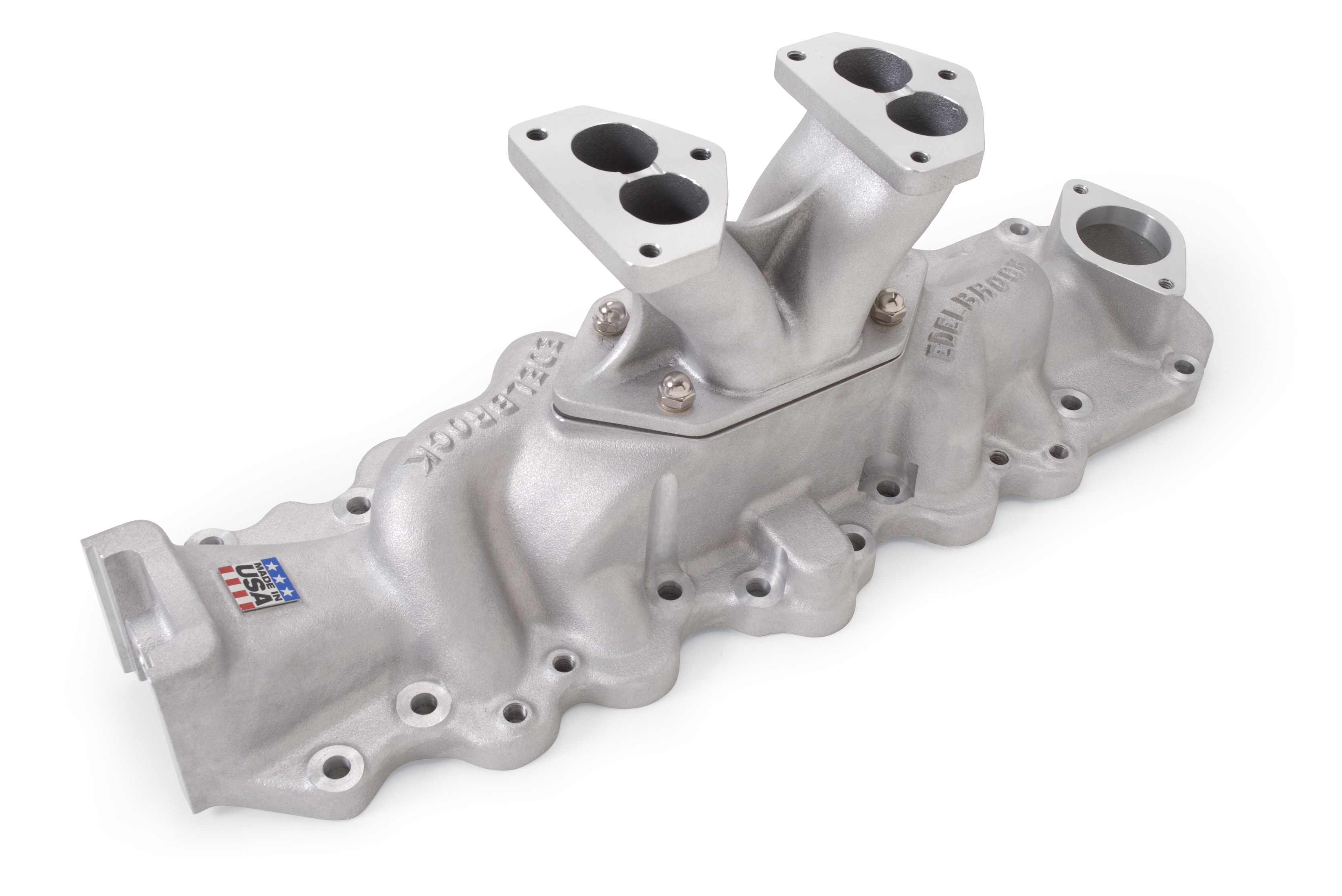

Here's a photo of the "current" Slingshot.
