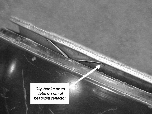

Interested in your experience/info/views on 35/36 Headlight Reflector Clips. "U" bend fits nicely into headlight bucket notches but square hole at each end of clip has nothing to latch on to on my reflectors. There are only small dimples or bumps on reflector that wont snap or hold onto anything. Maybe reflector another aftermarket product nothing like original?
Don Rogers | -- 04-14-2017 @ 12:24 PM |
If your reflectors have been replated, then those bumps are probably whats left of the tabs/hooks on the rim of the reflector. The tabs/hooks fit into the square holes on the spring clips. See detail.
