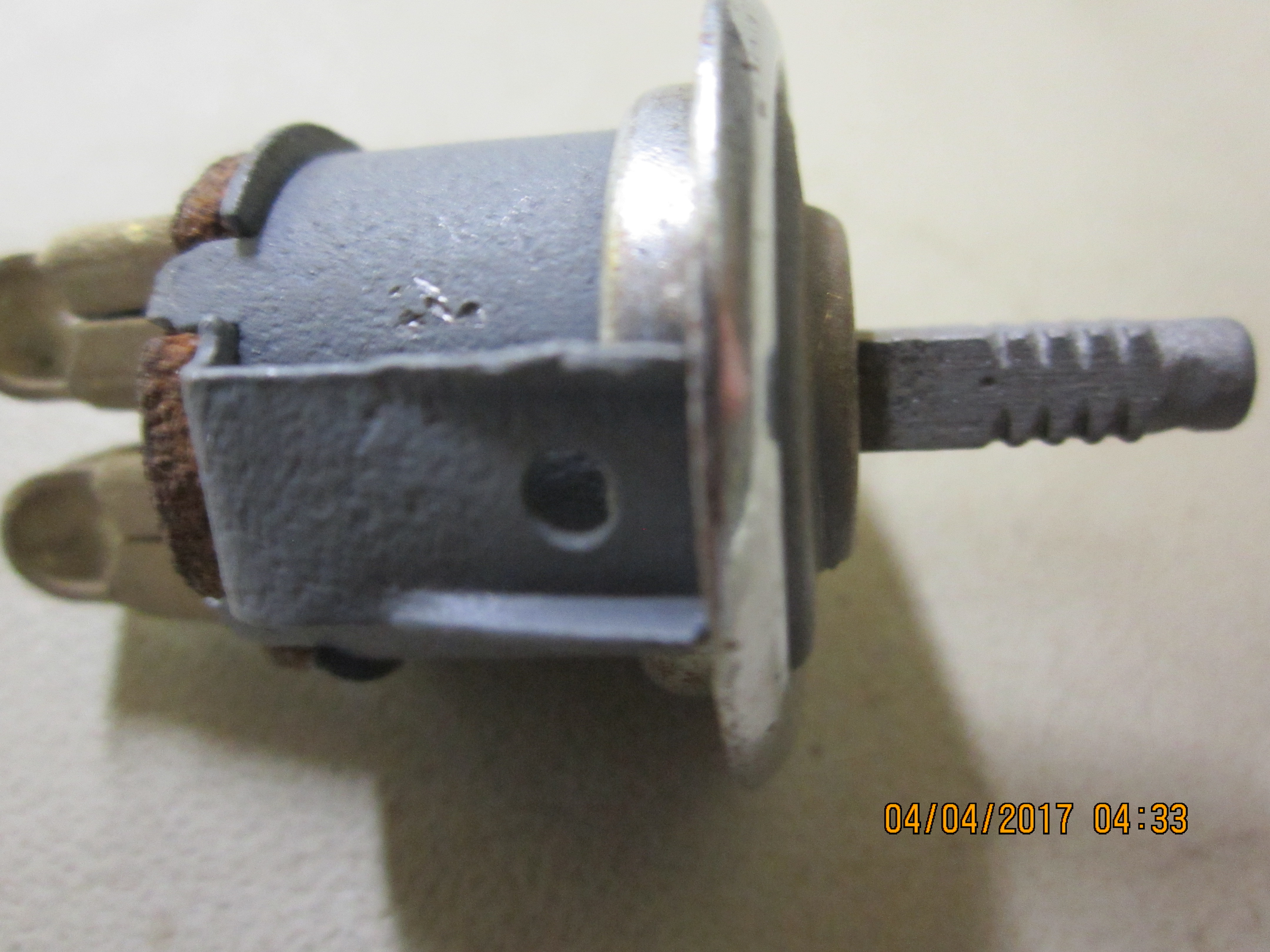

1937sedandelivery | -- 04-06-2017 @ 9:14 AM |
Hello, I put the knob in a vise and it crunched and deformed as opposed to cracking. From there it was easy to snip away at it until the pieces fell off. Then took the entire thing apart and cleaned it up. The internal contacting mechanism leaves a bit to be desired, not a lot of positive retention to hold the contacts together when the switch is closed (pushed all the way in). In any case, it is all cleaned up and some parts primered to prevent rusting. Attached is a picture prior to installing the new knob. BTW, to install the knob I heated up the switch shaft and the knob easily glides on. Take care to not slide it on too far (like I did), if you do the switch will be always open since the shaft is fully pulled out and can't be pushed in. Thanks guys.
