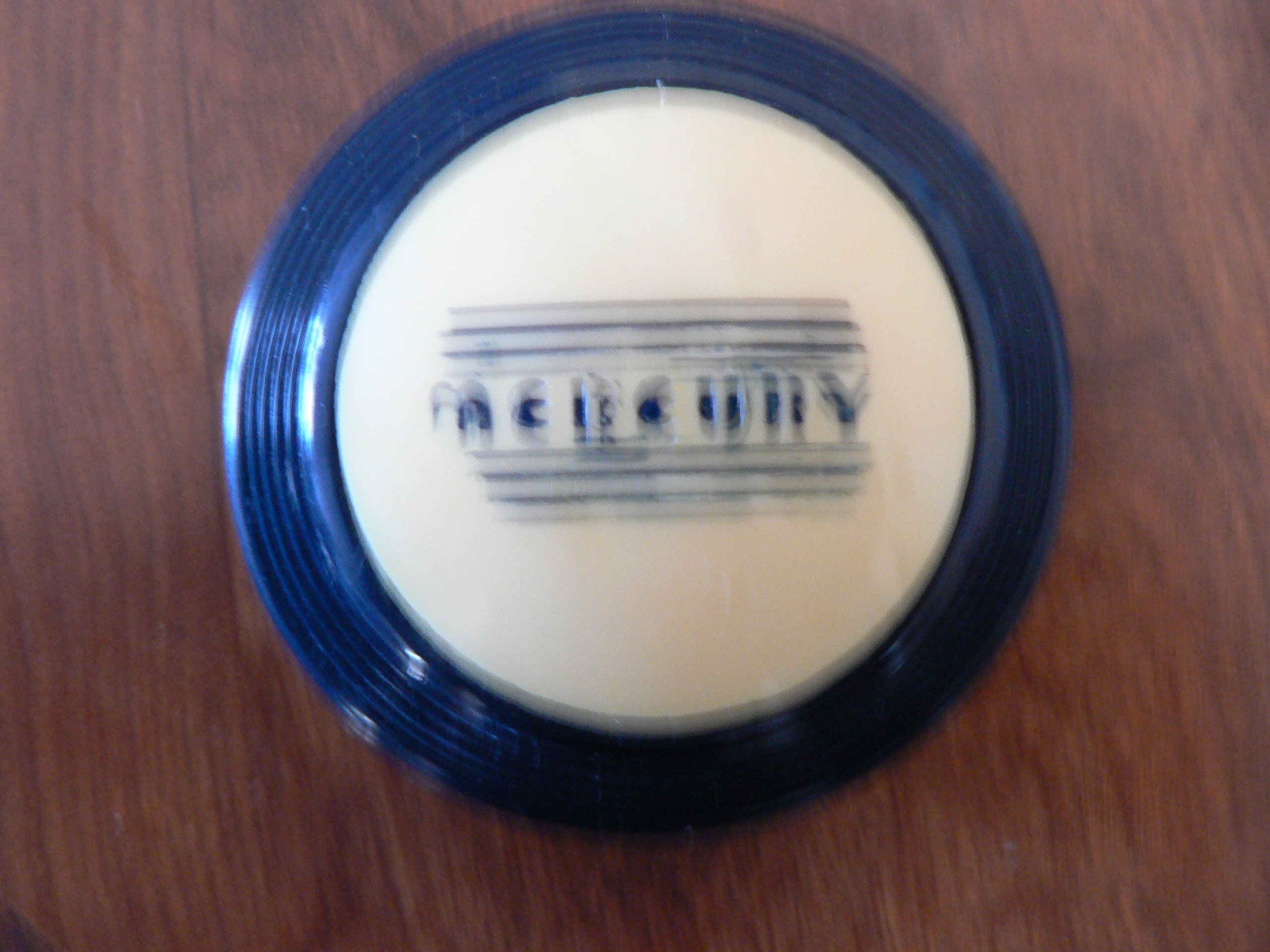

Rustymopar, That is a very nice car and you should be able to get your price. I saw your photobucket photos and the car does have the correct horn button. You may want to post the photos on Google photos, the photos seem to scroll faster on it. I don't have the room or the energy to handle another car, or I would be a buyer at that price. Tom
