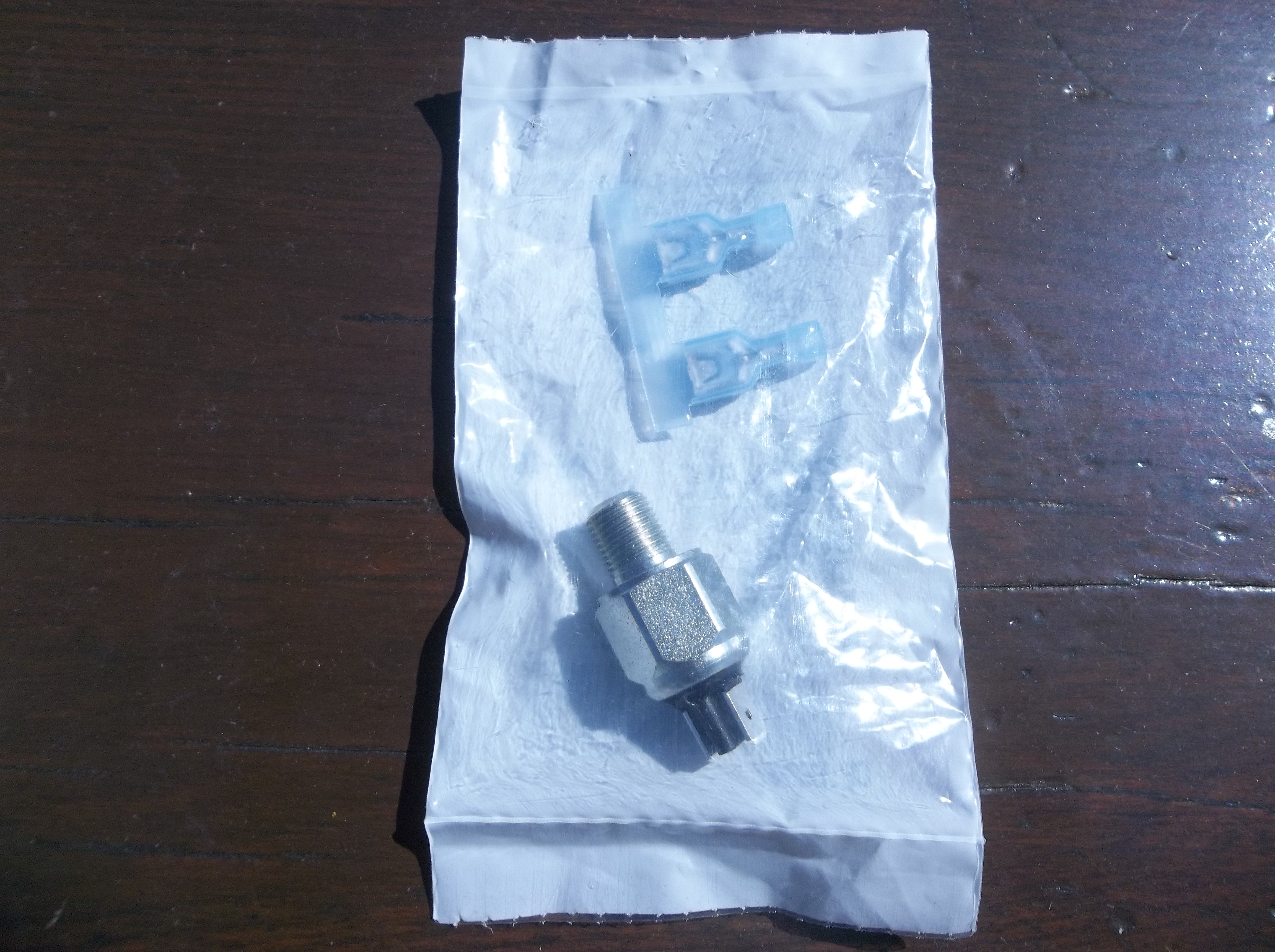

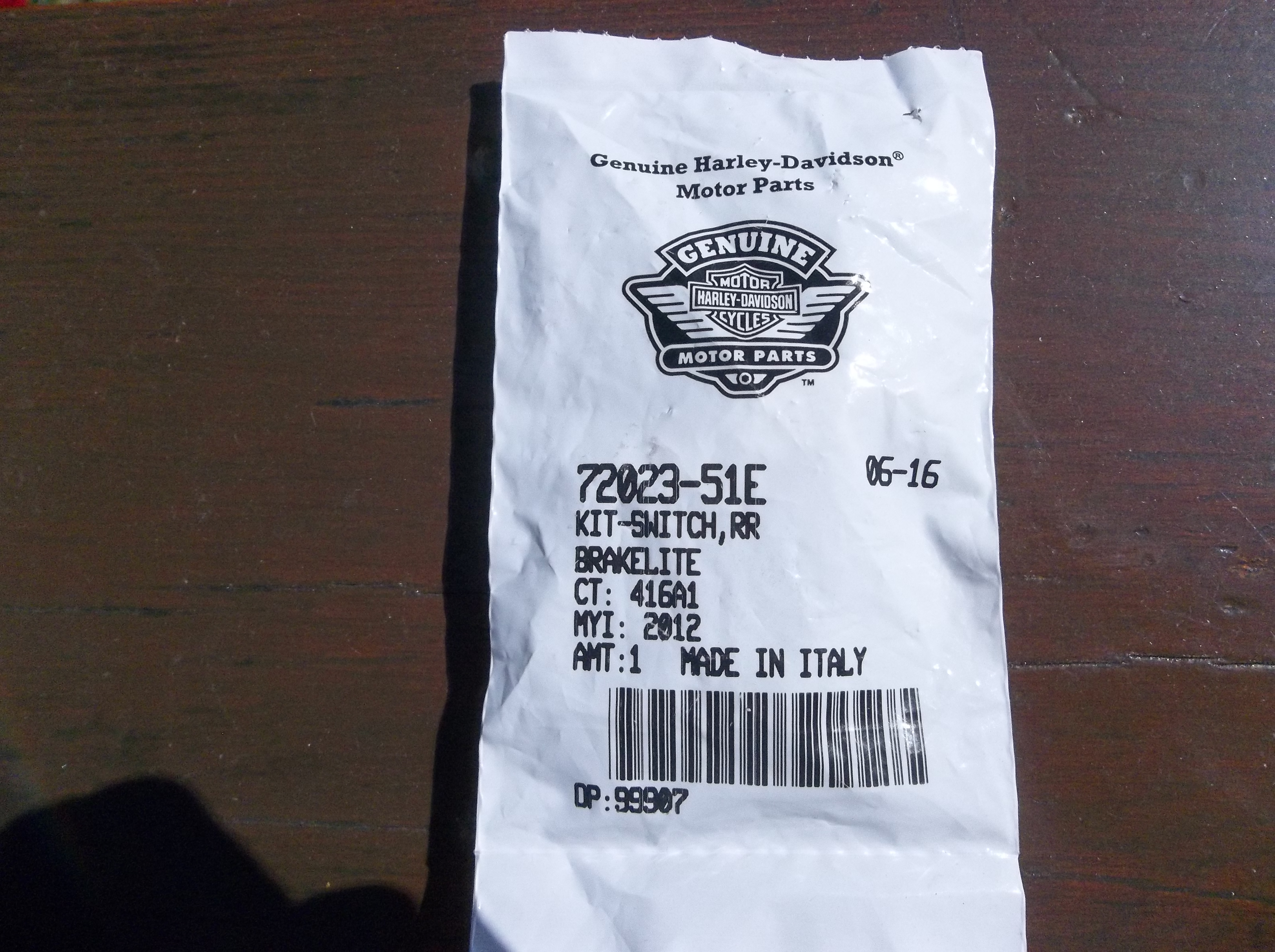

Thanks for posting the link, Jay. I don't know how to do that. If an EFV8 Club member has trouble obtaining the 72023-51E Harley Davidson brake light switch in their area, the part is readily available at the local dealership here. Send me a PM and I'll pick one up for you. Postage to anywhere in the 48 continental United States would be about $8.00 . Photo attached .........
Grant | -- 02-22-2017 @ 5:15 AM |
Second photo ..........
