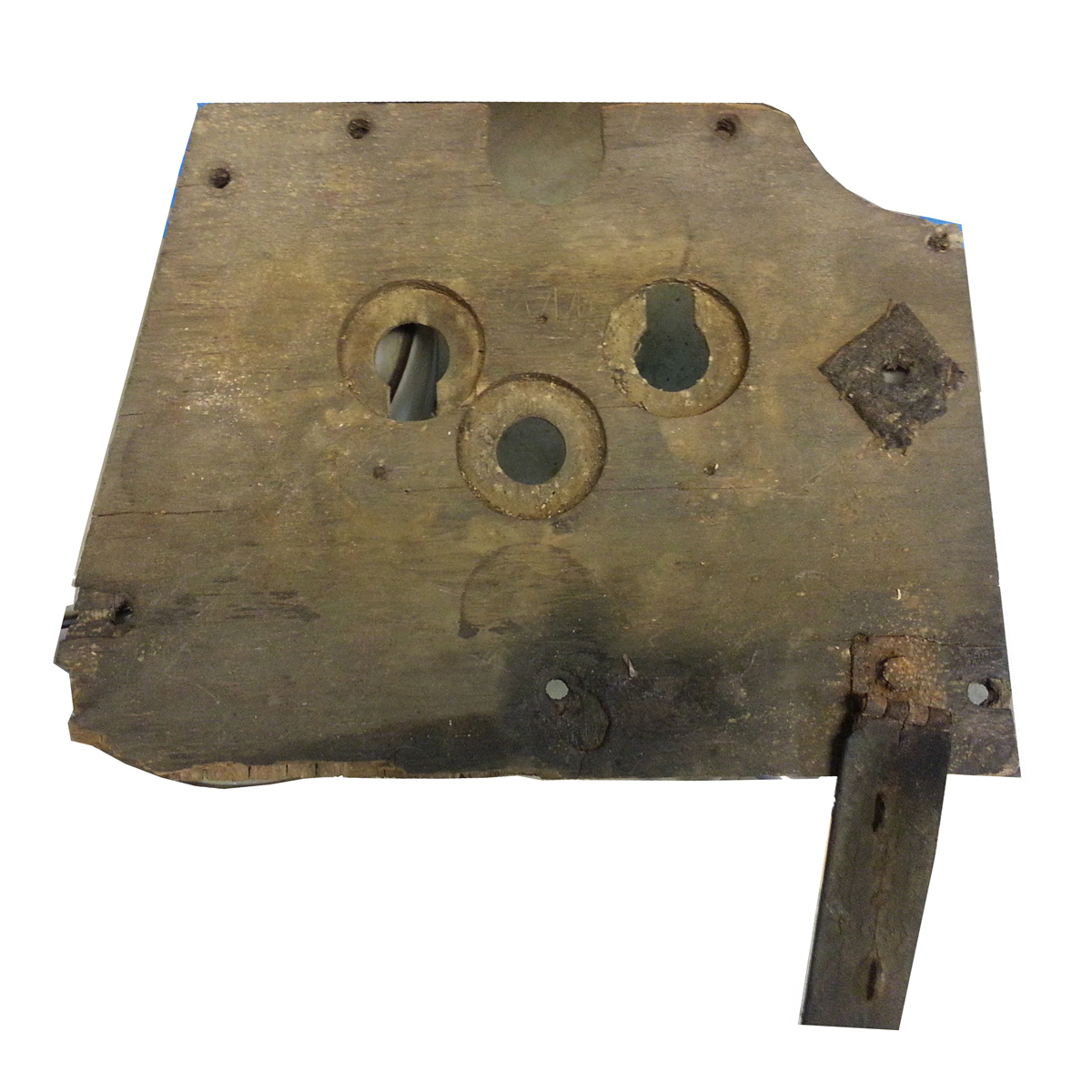

Don Rogers | -- 02-16-2017 @ 6:18 AM |
Here's a photo of the dust seal described by 40coupe.
