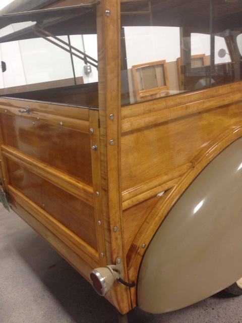

Stroker | -- 02-01-2017 @ 5:58 PM |
Woodiewagon46: I was "speculating" regarding 41-48. attachment hardware as I've never had the rear fenders off of a "fat-fender". I only have worked on my 38 Wagons, and the ones I'm familiar with have the fenders secured directly into the wood with what I can only describe as a lag/stud fastener which has wood threads on one end, and a hex nut/lockwasher/fender washer on the other. This particular Wagon is a "one-family" vehicle that was purchased new in 38 by my Father. We've owned it continuously since new. I HAVE had the rear fenders off in order to repaint them and install new welting, but I've never removed the "studs" that are threaded into the bottom of the fender arch wooden framing members. I have pulled these studs out of a "donor" wagon back in the early 60's, and (if memory serves me correctly after a half Century), that is what I recall seeing. As you have pointed-out, the attachment also passes through the inner fender panels in the rear cargo space. Below is a photo of a friends 38 Wagon that is currently undergoing restoration. You can see the "attachment interface" at the top of the rear fenders just below the ONLY remaining piece of wood in the arch. The fenders are supported by the stud that passes through the fender from the bottom side, through the inner fender, and the wood structure above. This gentleman has his work cut out for him, but he is a woodworker by vocation and has constructed several award-winning Station Wagons. Like Doug Carr, he can make wood from patterns on his CNC. He recently re-varnished my Wagon at his shop (see next post) This message was edited by Stroker on 2-1-17 @ 6:22 PM

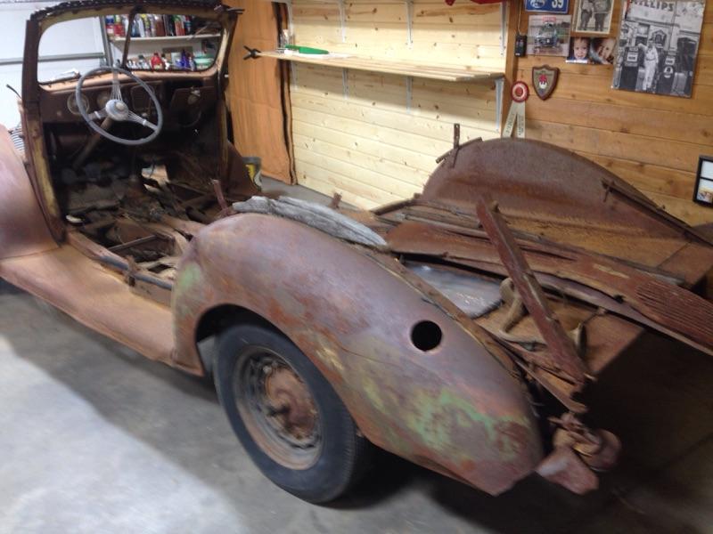

Stroker | -- 02-01-2017 @ 6:01 PM |
Here's my 38 showing the rear fender/wood interface. Yes folks, I KNOW the "Phantom" right-hand tail light is incorrect. I installed that years ago, so I could have a way of signaling a turn; given that today's drivers no longer understand my flapping left arm. I also use my amber fog lights for "front turn signals".. This message was edited by Stroker on 2-1-17 @ 6:32 PM
