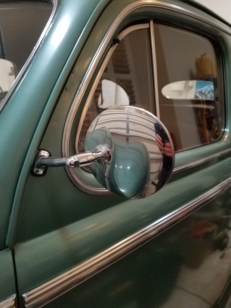

Suggest you try 'peep' mirrors. They attach to the top edge of the doors and once you get use to them, they work pretty well. I accidentally found the factory optioned 'peep' mirror for my 1949 Ford and I just mounted it at the 9 am point on the drivers door instead of the 11 am spot they are suppose to be. Yes -- meant to say o'clock....what was I thinking? This message was edited by nelsb01 on 1-31-17 @ 4:36 PM

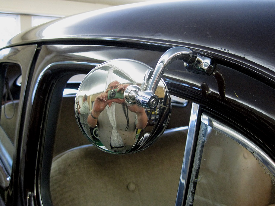

Here is what is on the '47. You can see where the original owner's rear-view was located at about 10-11 o'clock above where my mirror is mounted. 9 o'clock, as nelsb01 notes, works best for me and does not block the view of other vehicles/motorcycles/bicycles/pedestrians coming from the left at intersections. Also it does not require looking 'up' to see what is behind. Mounting it any lower on the door - the bottom of the vent window trim, seal and top of the door all begin to block the view of the bottom of the mirror. Btw - my driver's door mirror is adjusted by laying my head to the left against the window and adjusting the mirror so that, with my head tilted that far to the left, the left side of the car is barely within the view of the mirror on the right side. This way, when driving normally and sitting upright, when a passing car leaves the stock rear view mirror in the middle of the windshield it is fully visible in the driver's door rear view mirror. Once it begins to depart the view of the driver's door rear view mirror it is very clearly visible in my peripheral vision so basically no blind spot exists on the driver's side. Fwiw. Steve This message was edited by len47merc on 1-31-17 @ 6:00 PM

Ooopps - sorry. Picture rotated off 90 degrees. Seem to miss that a lot. Here it is hopefully oriented correctly. Meant to add that the nut on the back of the mirror matches the nuts on the windshield wipers if consistency is important to you. Steve This message was edited by len47merc on 1-31-17 @ 5:52 PM

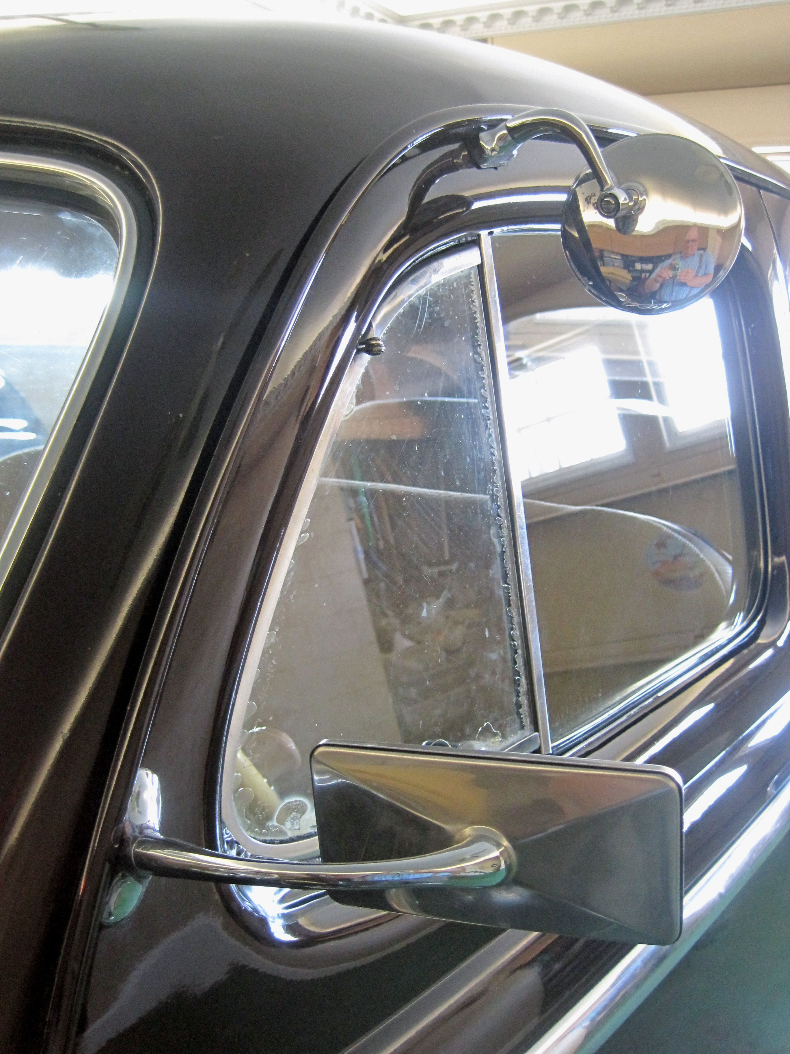

I like to keep the rectangular mirror as it came stock on my car. But I see a whole lot more with the convex (wide angle) peep mirror above it. See photo. This message was edited by Old Henry on 1-31-17 @ 7:22 PM
Old Henry | -- 01-31-2017 @ 7:20 PM |
I have both on the passenger side too, again, the rectangle one for looks and the convex peep mirror to see with.

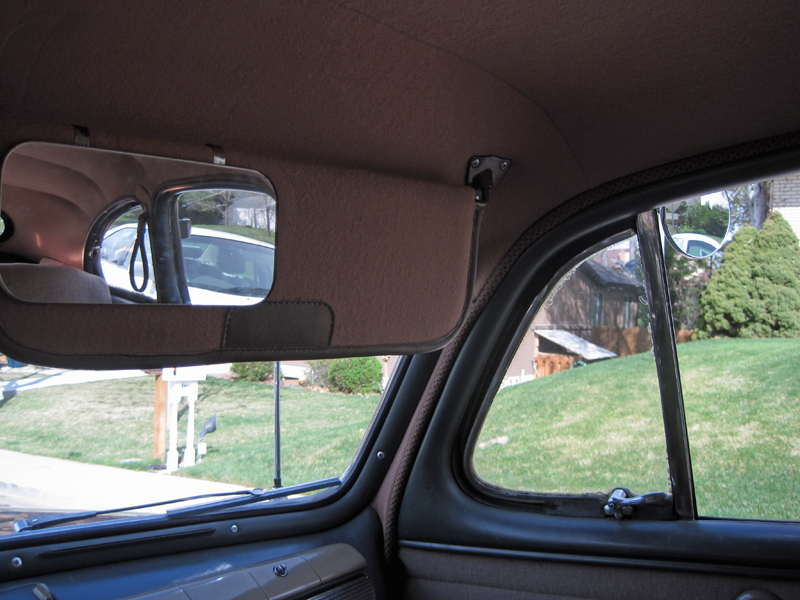

I found the best blind spot mirror is the one on the back of the right sun visor. Compare with the view in the peep mirror to the right of it. This message was edited by Old Henry on 1-31-17 @ 7:29 PM

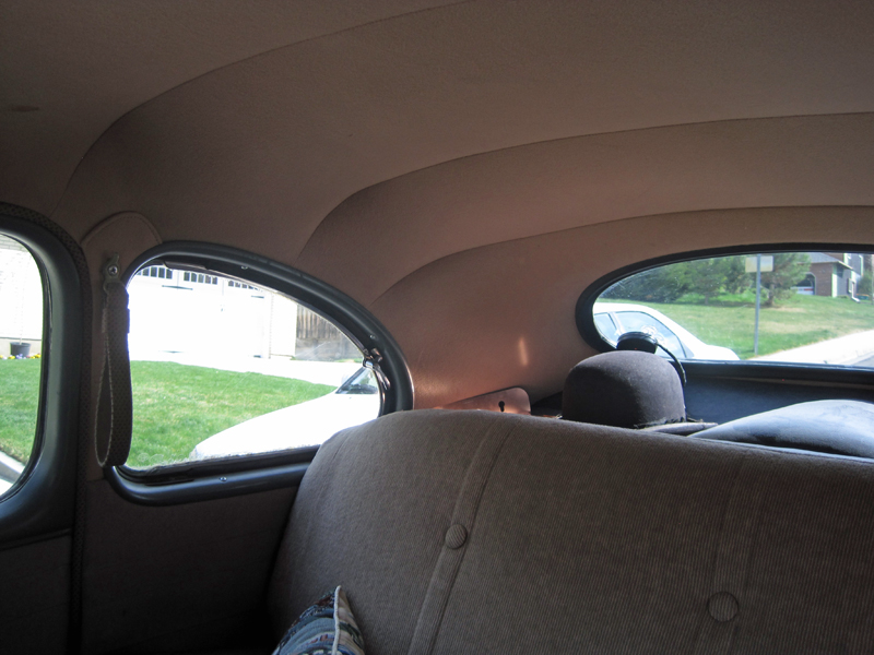

Here's my view of the same blind spot if I just turned around to see. Sun visor mirror is much better. But, I can't turn my head that far with just my neck. I have to turn my whole body, which is huge and stiff. So, I don't do it. I pull down the visor to check, especially on the freeway when I don't want to take my eyes off the road to move to the right. This message was edited by Old Henry on 2-1-17 @ 9:27 PM
