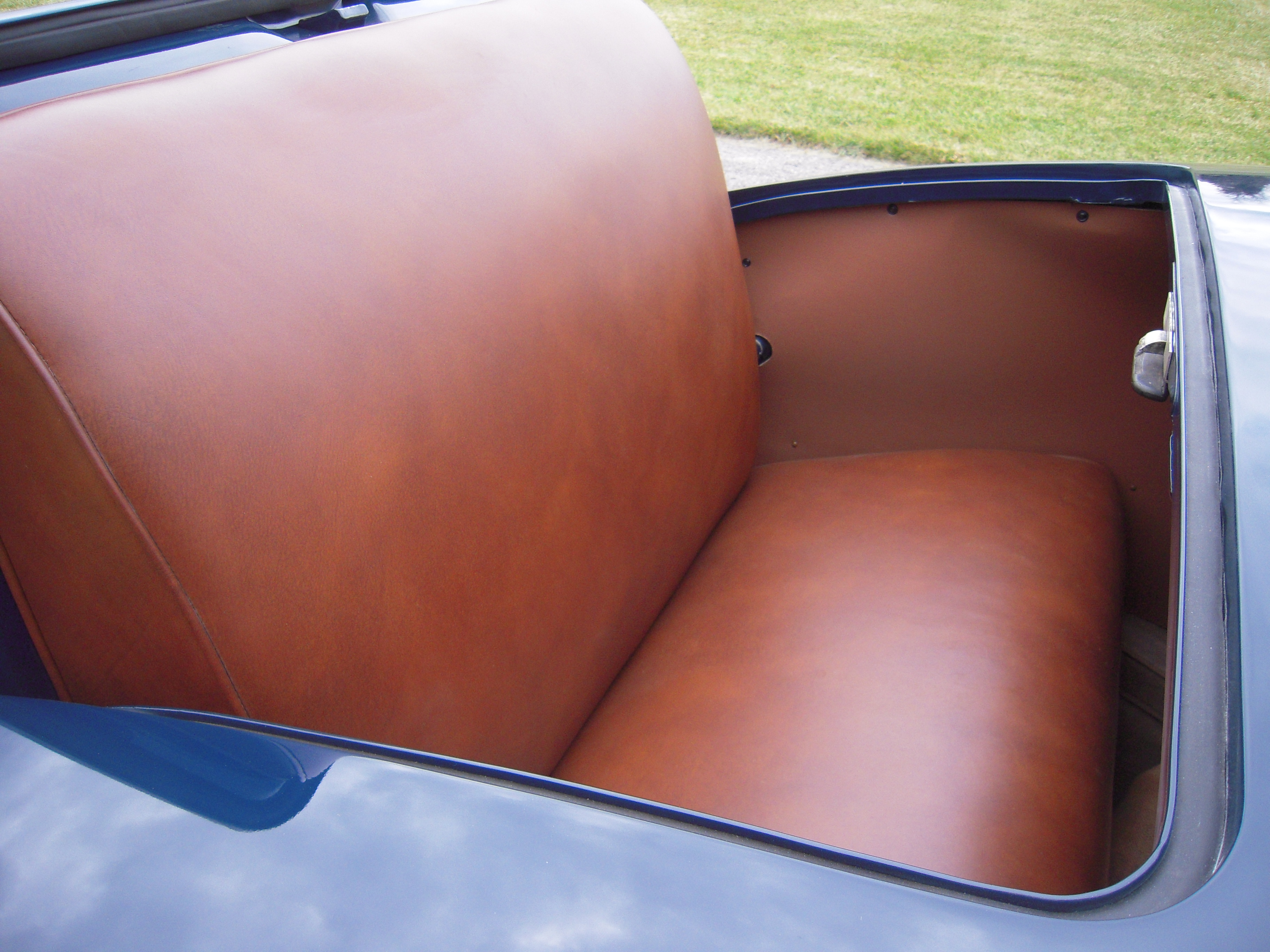

thunder road | -- 01-29-2017 @ 9:34 AM |
Thanks to every one who 's helping me with my madness. I am only using the picture of this particular car because it shows the deck lid area nicely, But this is why belonging to a club is so helpful, people looking out for other members. The seam I am talking about is the lower steel rumble seat lid gap in the steel deck lid. When I look at the lower deck lid handle it looks like it can open like a trunk? if this is so , and the lid from the coupe, or sedan is not a perfect fit, I would just get an extra rumble seat deck lid and steel fill it closed with an extra steel rumble seat lid, extended. Domenic Domenic This message was edited by thunder road on 1-29-17 @ 10:41 AM
ford38v8 | -- 01-29-2017 @ 12:18 PM |
Dom, I'm still unsure of what seam on the rumble lid you refer to, but I'll take a stab at it: The car body accent beltline that runs from the front, around the back, swoops down and meets at the bottom rear? This same or similar beltline appears on all Fords of the era, regardless of body style. For a trunk model car, it sometimes becomes the lower edge of the trunk lid, but on models having rumbleseats, the rumble lid is the only opening, and not an additional opening cut into a trunk lid. You've either got one or the other, but not feasible to have both. As Kube has said in his later, more polite post, a trunk model requires additional bracing inside to compensate for its lack of structural integrity due to the large trunk opening. I understand now that the car you pictured is not yours, but used only as demonstration of your question. In Kubes defense, I had, as I think others may also have misunderstood, thinking the car was yours, and his post was an insult directed at you. He has now sent me a private note, indicating that I had insulted him. ...Oh, well, he and I are known to disagree, but this is just silly! Dan, that Kari Keen is just what my Granddaughter needs on her Smart Fortwo! Alan

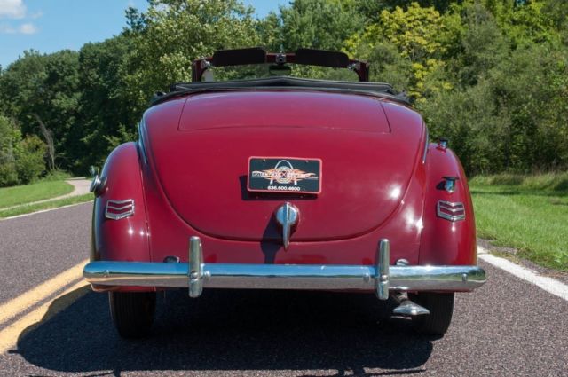

thunder road | -- 01-30-2017 @ 3:53 AM |
The car that I wished ford would have built in' 1939' and '1940' is basically the coupe body with the small convertible top of 1939. This car would have used the same trunk lid, and would have had the same full size trunk as the coupe. It's only now that I realized that they never did this in 1939. This would not have been hard for them to do since they already had the coupe body to work with. Lastly can someone tell me what that trunk handle looking thing with the license plate light in it dose since it appears this dose not open and is not a trunk, in the picture . Domenic Domenic This message was edited by thunder road on 1-30-17 @ 3:58 AM
TomO | -- 01-30-2017 @ 7:26 AM |
The handle in the photo is for opening the rumble seat. Tom
ford38v8 | -- 01-30-2017 @ 4:58 PM |
Dom, Ford's marketing department had to consider offerings from it's new Mercury division as well as from Ford, in order to prevent direct competition with each other. It's easy to play Monday morning quarterback and say what they should have done, but they had the numbers, and took actions based on their observations of the market at that time. The handle below the license plate was indeed a release mechanism for all models. A trunk latch is easy to imagine in that location, but for the rumble latch, it was connected by cable and pulleys, around the side of the body, up and around to the top of the ruble lid latch. If you look at Kube's picture from yesterday morning, you'll see the latch itself. Alan
