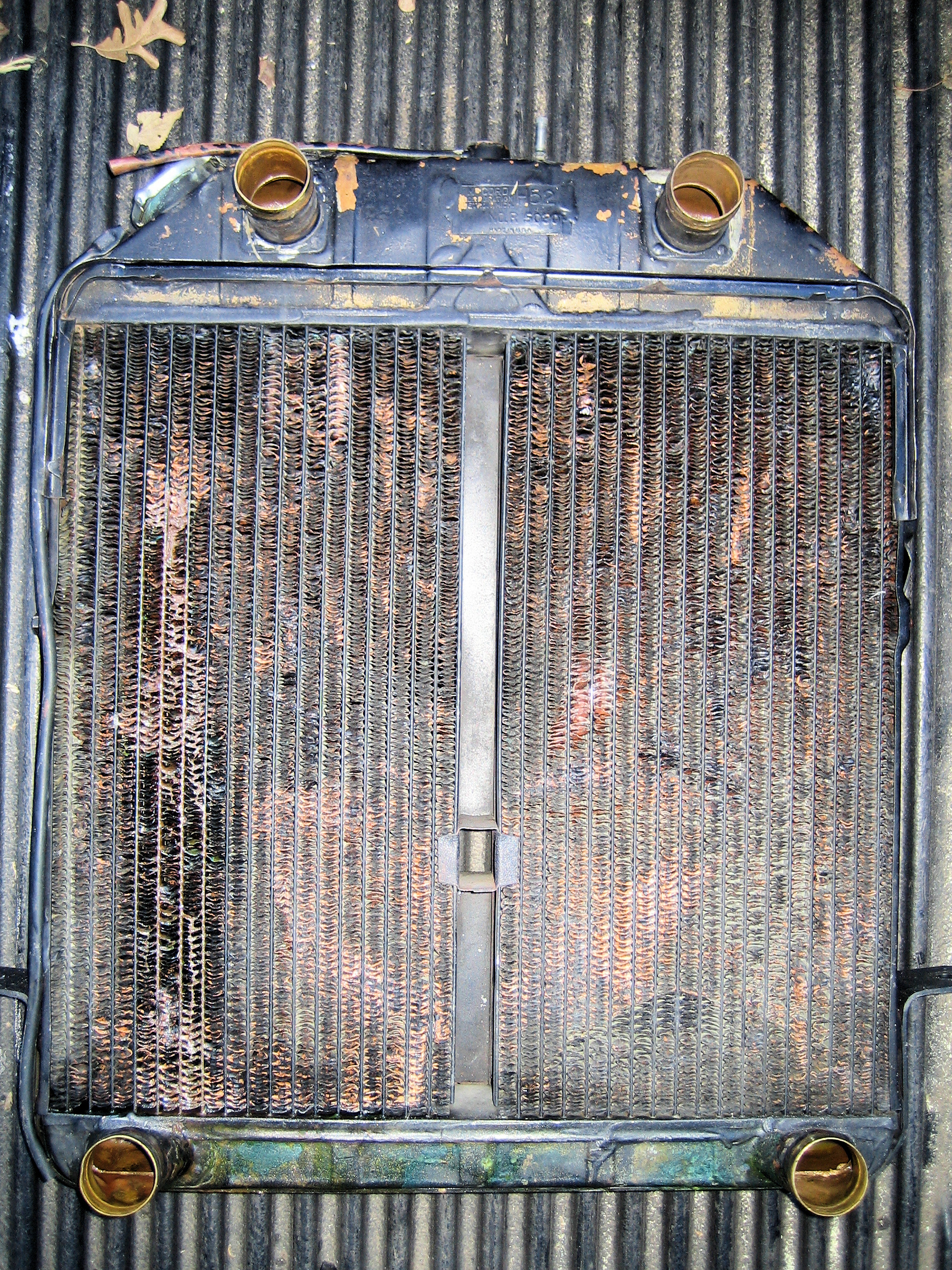

I've posted a picture of the fan side of the radiator that I pulled out of my '39 Deluxe yesterday. We have one radiator repair shop in the Twin Cities that will do an old brass radiator that I am aware of. When I took it to them today the guy thought it had been re-cored (incorrectly as Henry built it) sometime in the past. Specifically, he thought the cores should fill the inside slot between the split above the hole for the crank. On the outside there is a piece of solid metal about an inch wide that covers the gap between the cores, but has a hole to allow for the crank. And he also thought it should have finer fins then the one I've got. This is a very original car. But not a show car. He said he is not an expert on old Fords and would look into it for me, and let me know before proceeding. Depending on what he thinks, I am thinking to re-core it, rather than repair it. Out of curiosity, I thought I would ask the Ford experts here for your opinions. What do you think of the originality of this radiator? Thanks! This message was edited by 39Fordfan on 1-12-17 @ 3:47 PM

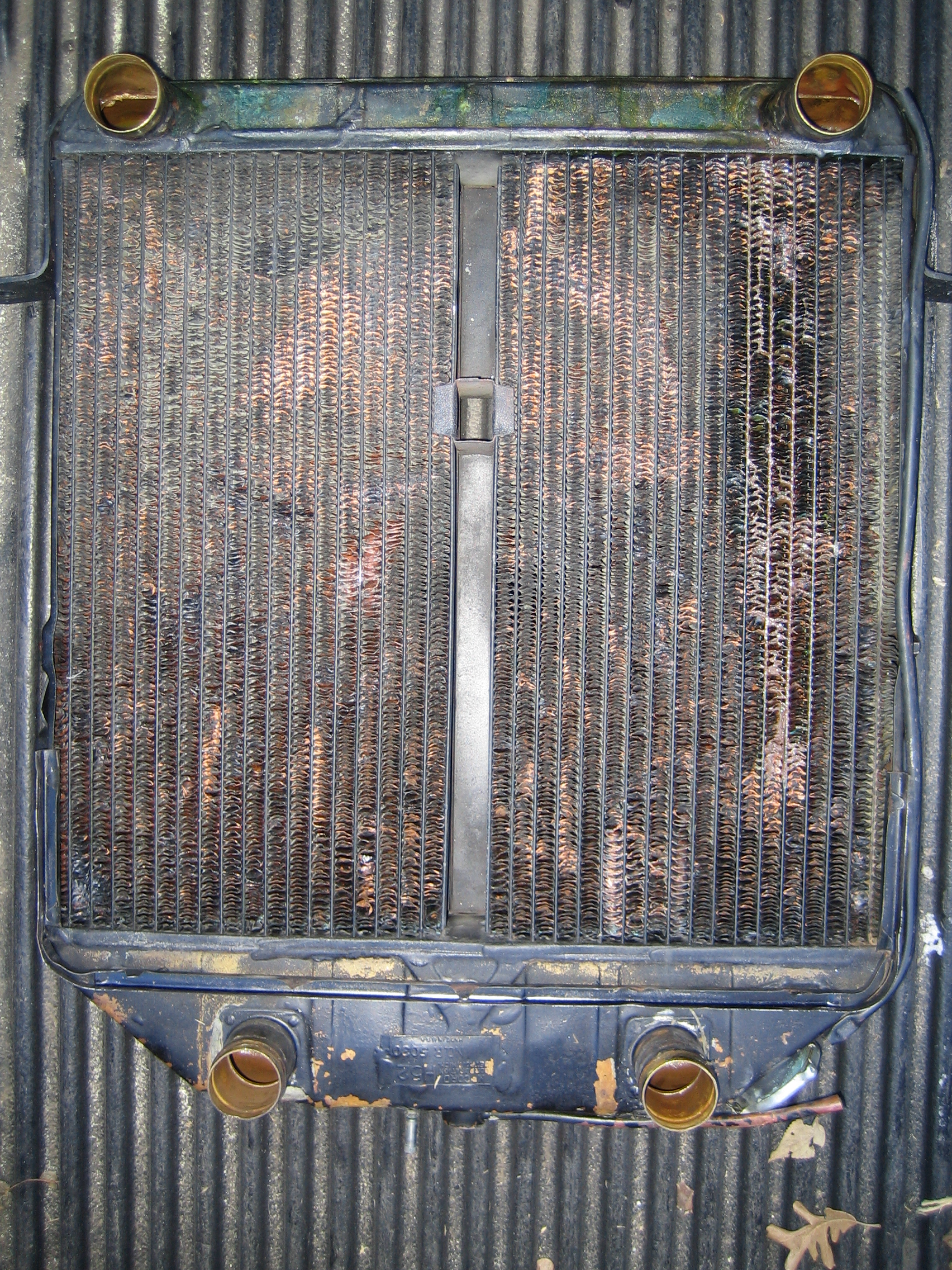

This the fan-side of the radiator top side up. I'm not sure how to correct the picture above, that is upside down... This message was edited by 39Fordfan on 1-12-17 @ 3:53 PM

That's a "ribbon fin" core. The originals had a "straight fin" core. This message was edited by trjford8 on 1-12-17 @ 4:57 PM

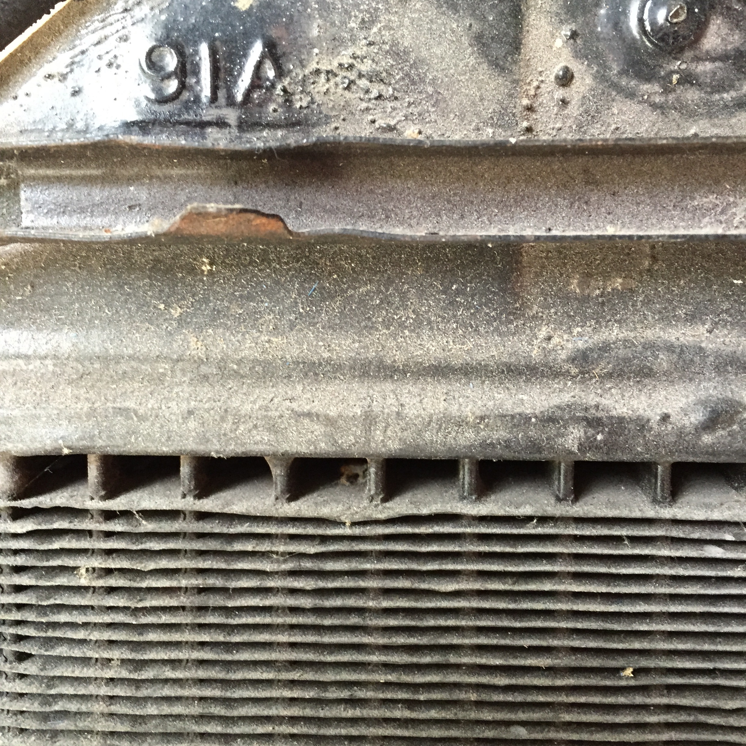

Ford had a couple of suppliers for radiators, so not every radiator is identical. Your radiator looks correct. split core is good along with the one sheet metal insert pictured in the split, the position of the cap. The metal channel for the light harness looks correct also, but it is usually mounted slightly lower. Many have a stamping in the top tank, under the cap, on the engine side, 91A. The soldered on tag in the center of the top tank is only a sign the radiator was worked on at one time. This message was edited by 40 Coupe on 1-13-17 @ 4:31 AM

I agree with Alan in that this one has been re-cored at some point. It is not authentic. I have my radiators done locally for around $500 each. I take the tanks and brackets home, restore them and return to be installed to the new cores. Mike "Kube" Kubarth
