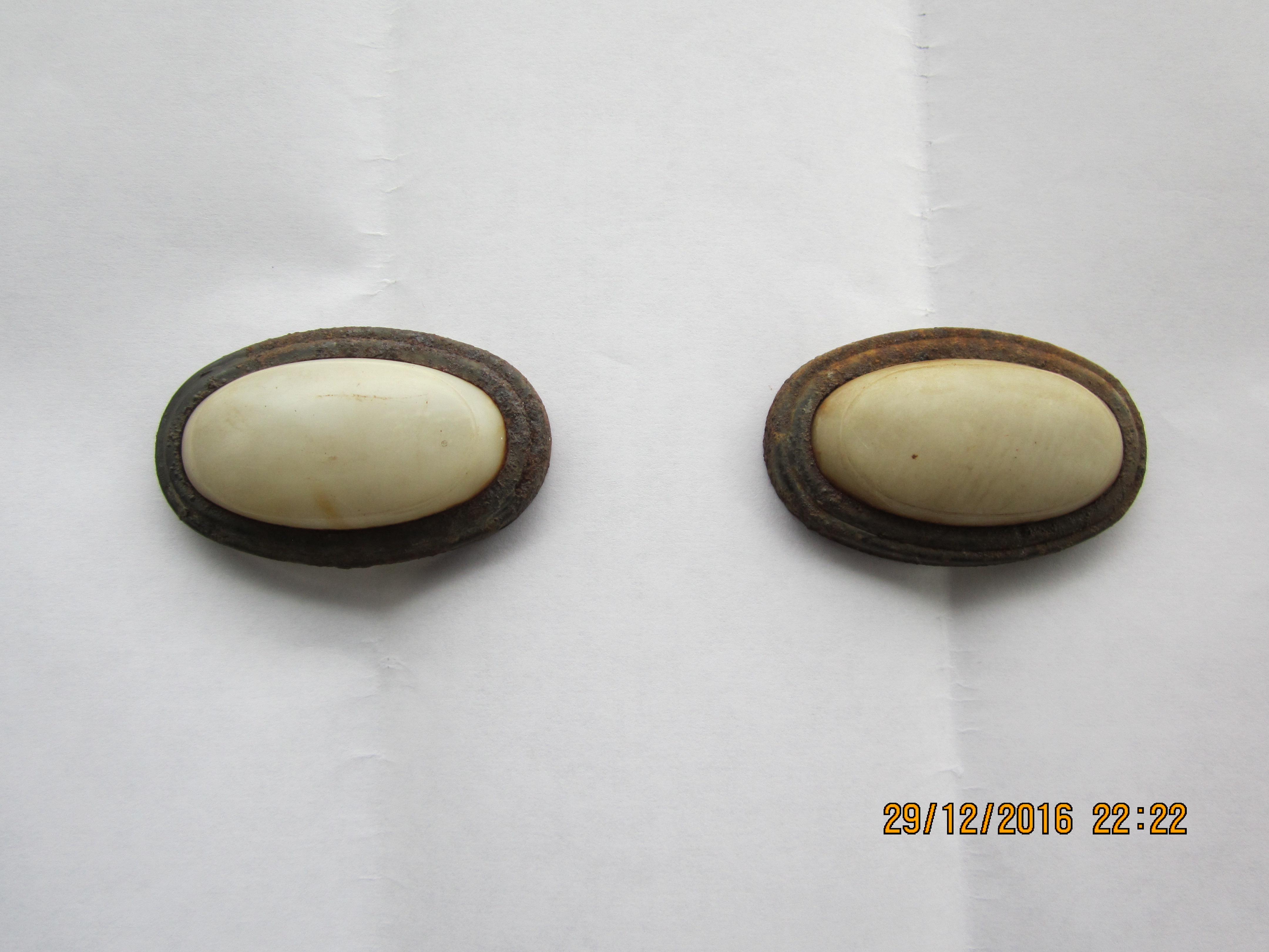

Hello, I recently purchased a pair of original 37 Dome Lights, knowing that they were in need of restoration. Now that I have them, I am not sure how to clean up the glass domes. I don't expect to make the glass like new, but I do want to remove the rust stains that have accumulated around the periphery where the bezel is. Please see attached photo. Any recommendations on a cleaner/cleaning method? I do plan to remove the glass from the bezel, just haven't attempted that yet. Thanks, Gregg

In all probability those lenses are plastic. On those I use a tooth brush with some biodegradable cleaner like Simple Green or Fantastic. if the stains are really tough you can use triple O steel wool with the same cleaners. If you need to de-rust the bodies, rims and retainer rings, put them in a small container with white vinegar. Takes about a week but they come out nice and clean.

Super. I will give the domes a scrubbing. I think they are glass or ceramic of some kind, not sure though. The metal pieces are in really bad, rusty condition. Good tip on de-rusting them, I will give them a week to soak. Thanks! gregg

Hi trjford8, Am circling back to close the loop. The lens are plastic and in pretty good shape. A little Fantastic cleaning/brushing and they look almost as good as new. The lamp housings were rusted very badly, but the vinegar did the trick. It exposed several rusted through holes that now, should work nicely to provide some heat ventilation! The retainer spring on the wire that contacts the bulb end was gone so I had to fabricate something, it keeps constant pressure on the contact surfaces. So, all is good and the dome lamp is back together in excellent condition. Thanks for the tips. Gregg
