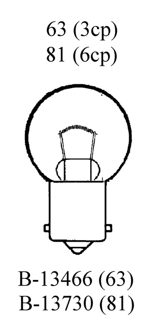

1935 Ford dash lights are notoriously dim, but there is one thing that you can try. Remove one bulb and look for a number on the side. If the number is "63" it is a 3 candle power bulb and can be replaced by an "81" which is a 6 candle power bulb.

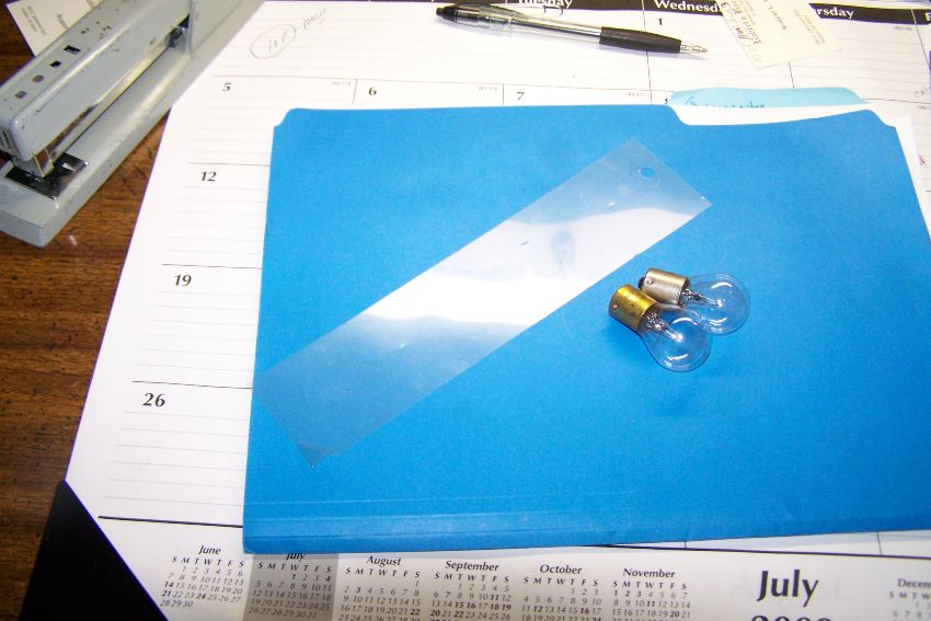

Try this. The speedometer and the dual gauges have a light slot that has a green piece of plastic covering the slot. Over the years this plastic gets brittle and opaque. What I have done to increase the display is remove the green plastic strip (easy to do) and replace it with a piece of clear plastic. I use the plastic sheeting commonly used for overhead projectors and is readily available in most office supply stores. It comes in a variety of colors (single sheet about 10 Cents). It is also somewhat heat resistant. This can be of concern when going to bigger light bulbs such an #81. One sheet should give you a lifetime supply! Hope this helps. Tom
