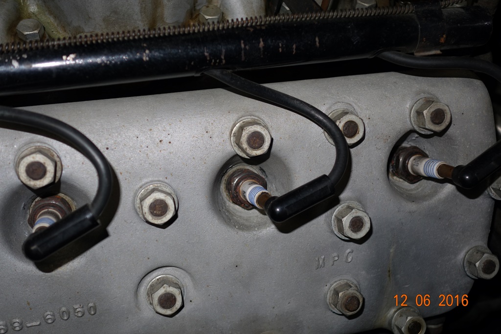

Bob56 | -- 12-06-2016 @ 8:42 AM |
I thought my plug wires were one of the things wrong when I bought my car (1936 Club Cabriolet) but after reading the 1935/36 book from here they appear to be the correct radio suppression plug wires. Am I correct? I thought I had several things that were odd but after reading parts of the book looks like the only things I need to change are the coil and fuel pump

Bob56 | -- 12-15-2016 @ 2:39 AM |
I wasn't worried about radio reception but the correctness of the plug wires themselves. I have only been to one V8 club show and all the cars had the loop plug wires. When I look on page 118 of the 35/36 book mine appear to be correct. Looking to verify before I change something that not wrong

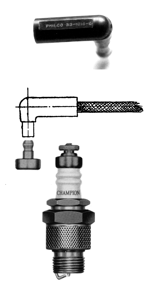

Don Rogers | -- 12-18-2016 @ 7:06 AM |
Bob, Your spark plug resistors are correct if you have a radio in your car. Below is a photo showing more detail on the spark plug resistor. What is your goal with your car? Are you wanting to show it on the concourse at a V-8 meet or just get it close to original? If you are going for concourse, then you will need to do more to restore the ignition system. Original plug wires were not rubber coated. They were black fabric with a dull lacquer coating. Also, your plugs should be Champion #7 2 piece as shown below. Do you have all the noise suppression condensers? There is one on the coil, generator, oil sending unit, electric gas sending unit, dome light and coil resistor(on firewall). Bob, if you just want to enjoy the car and drive it, don't worry about the details. If you want to restore it to original, then you need to do a lot of nitpicking corrections. Enjoy the car!!!
