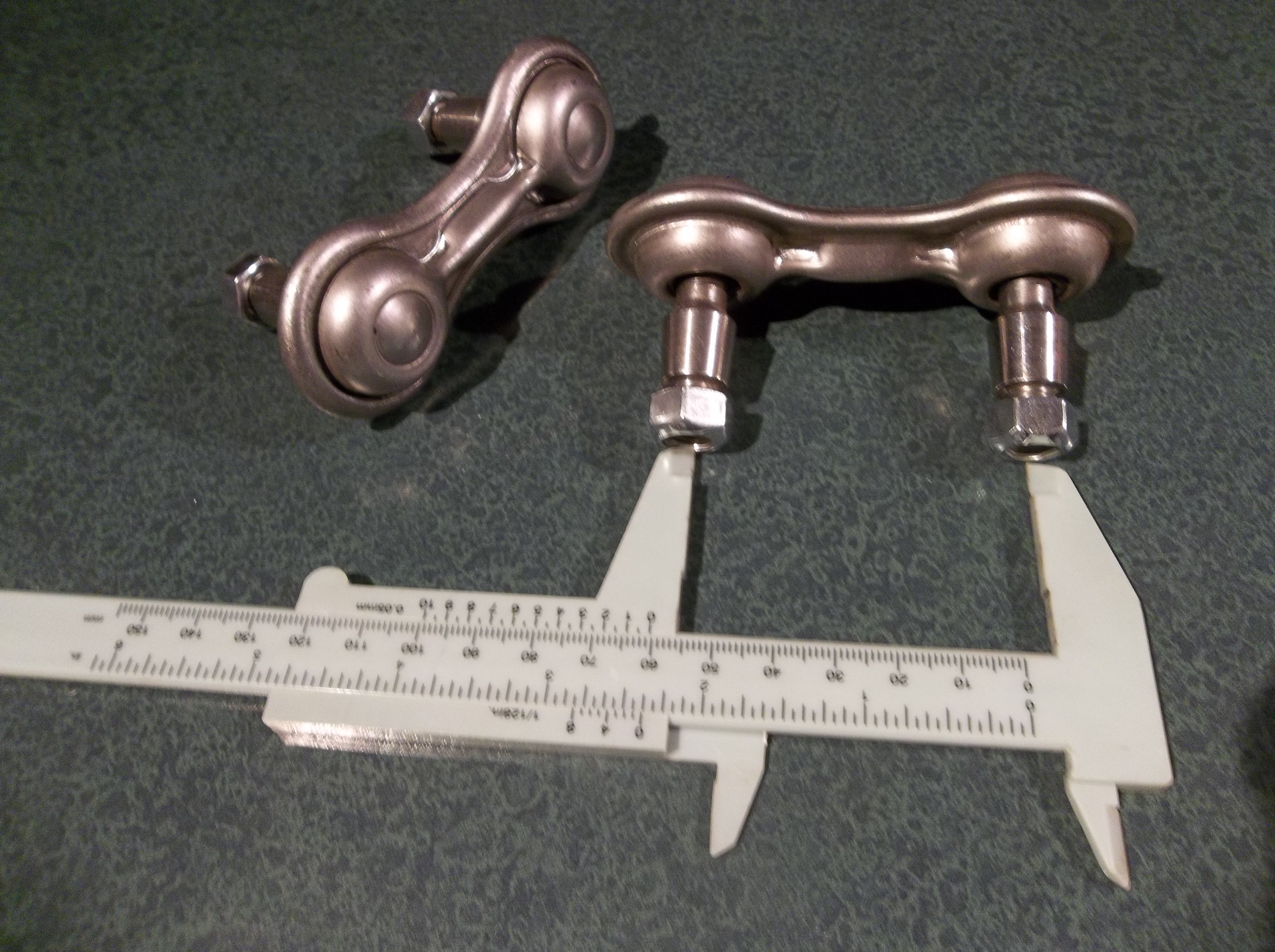

Does anyone recognize these shock absorber links ? The center-to-center measurement between posts is 2 3/8 inches in the position shown. These appear to be nice quality reproductions with stainless posts that swivel. I've run across Ford and Mercury 3 inch and 4 inch shock links, but never 2 3/8 inch. What vehicle are they intended to fit?

Try part # 21A-18055-A, front torsion bar link for 1942-1948 passenger. This message was edited by OH37FORD on 11-26-16 @ 5:01 AM

Thanks for your input. Much appreciated. Looks like your I.D. is dead nuts right on. O'Reilly Auto Parts lists these for $27.99 each.
