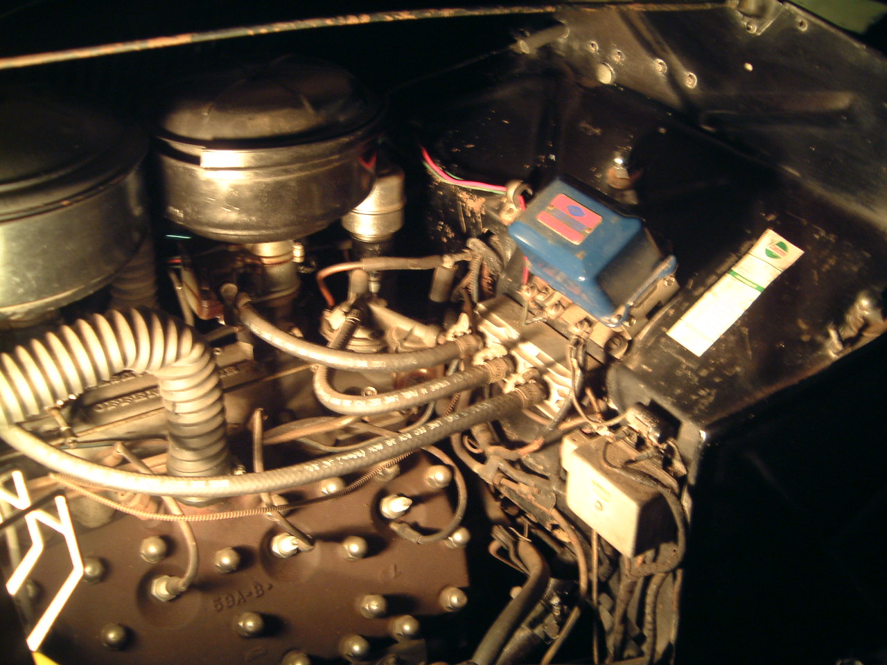

When I converted my '36 headlights to sealed beams I eliminated the stock lighting switch from the bottom of the column. The original switch was problematic at its best due to age. I installed a pull switch in the dash hole which was for the hand throttle, I then moved the starter switch from the area between the clutch/brake, installing a modern dimmer switch in it's place. I installed a push button starter switch on the left side of dash, similar to the later model Fords. Cleaning up all of the wiring mess it was much easier to place the headlight relay on the left side of the firewall above the column and run the necessary wires to the switch, etc.. Bill 36 5 win delx cpe
