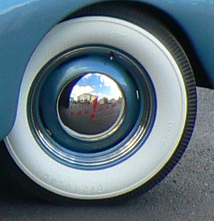

TomO | -- 10-03-2016 @ 9:07 AM |
Here is the tire from my Merc Tom

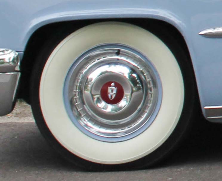

56MarkII | -- 10-14-2016 @ 11:16 PM |
I have Firestone Deluxe Champions on my Merc and Continental and for years all I have been using is Spray Nine and a stiff bathroom brush used for cleaning hands and fingernails. The only time I ever used steel wool is on curb scuffs. My tires are quite old now on my Merc and never had issues using this cleaner. Also regarding tire pressure I always run 32-34 PSI in these tires with even normal wear on my 50 Merc and very heavy 56 Continental.
