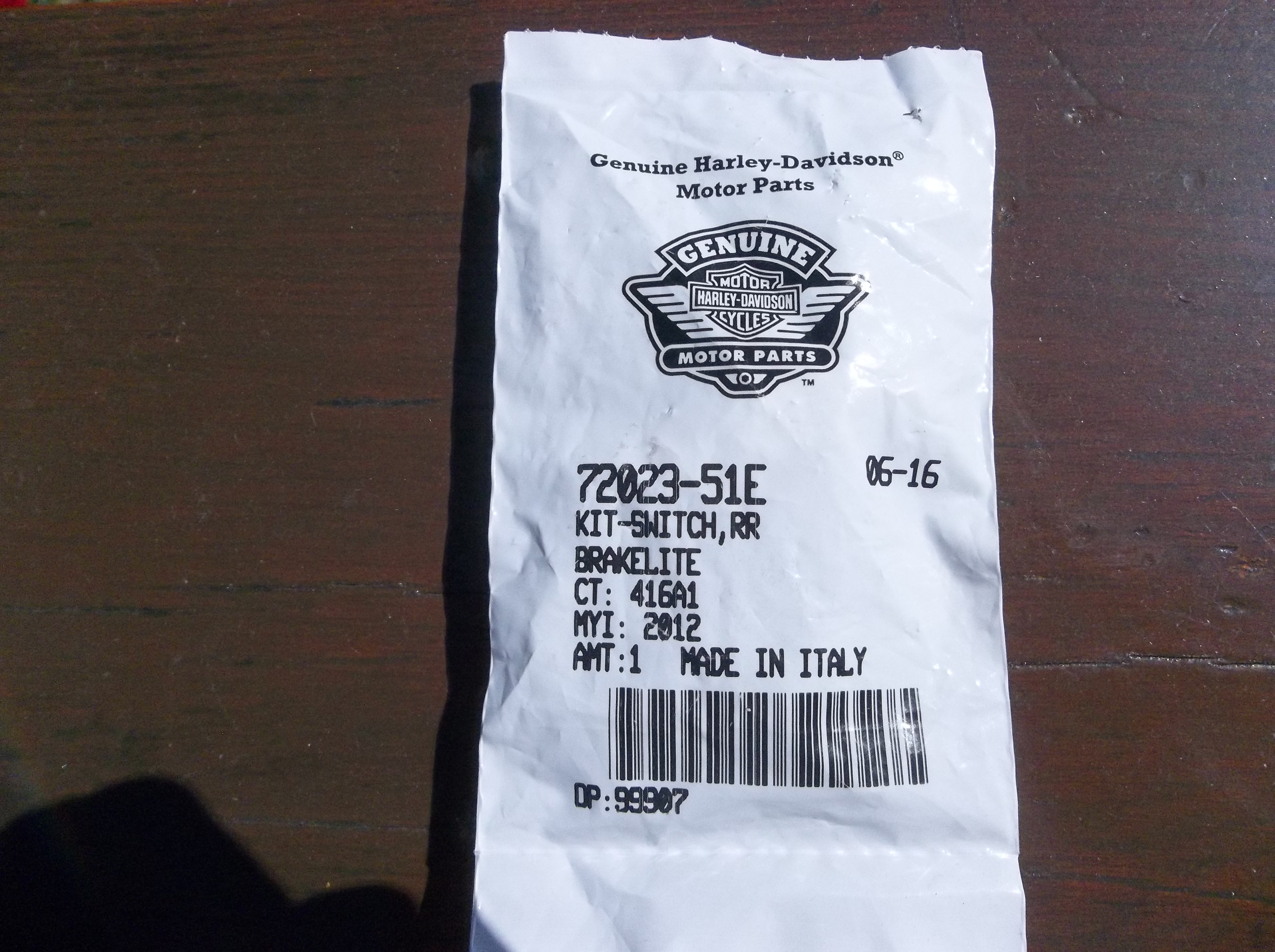

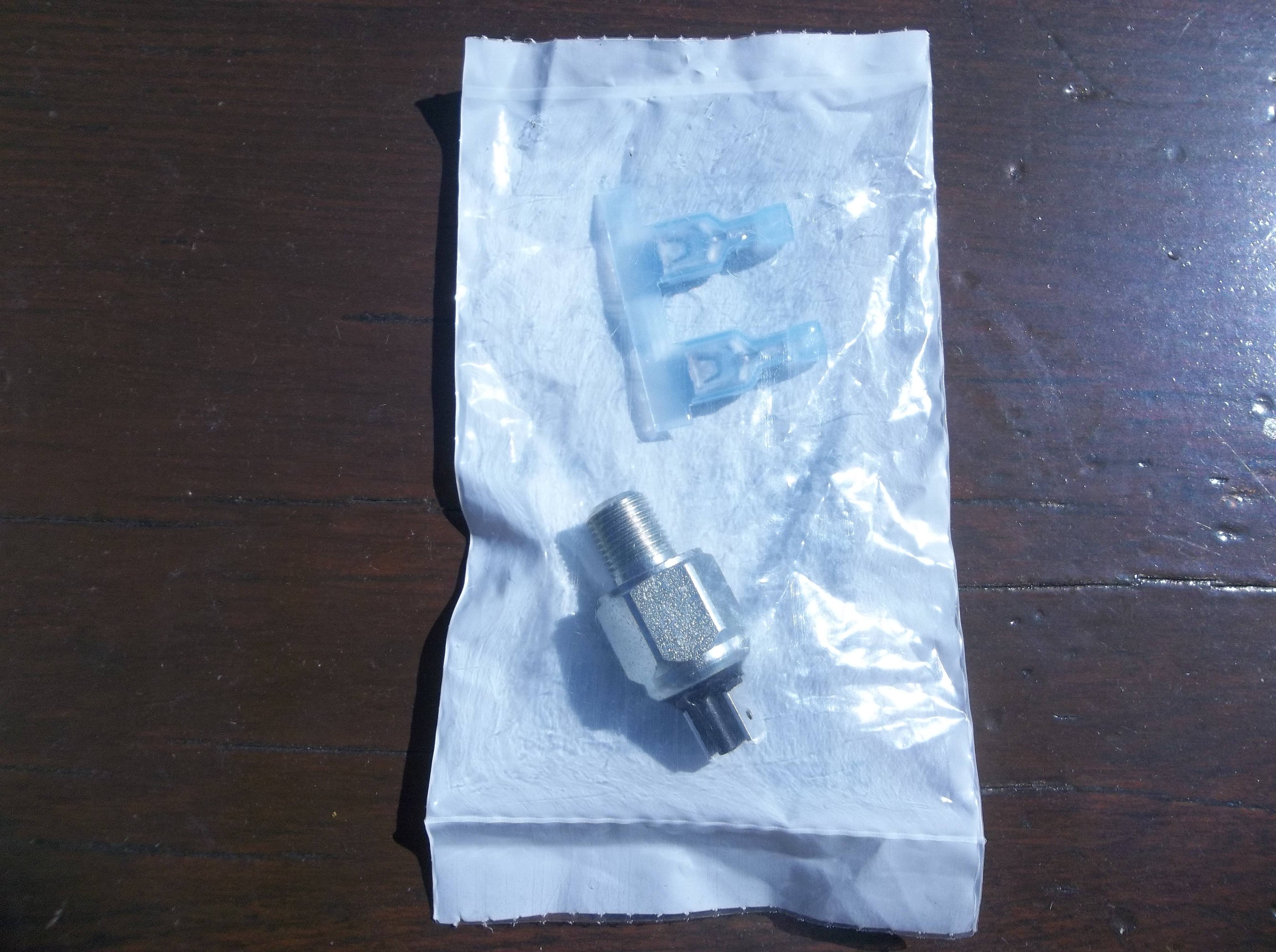

I have found a twenty year old Dick Flynn Tech Tips article which says: "Silicone brake fluid works its way back into the switch diaphragm and stops the switch contacts from contacting. This prevents the stop lights from lighting. A very dangerous situation!" Also........."the Harley Davidson stop light switch is a perfect replacement for the standard V8 stop light switch. The only modification required is a set of short jumper wires because the contacts on the Harley Davidson switch do not accept the bullet connectors used on the V8s." And.........."The H-D switch part number is #720023-51A and costs the grand sum of $17.50." Making a trip to the local Harley dealer was the answer to our problem. Their hydraulic switch is now on the '36. The brake lights are working great again . That old part number has been superseded. It's currently sold as 72023-51E for $27.95, complete with two new connectors. Made In Italy, for some reason. See photos.
Grant | -- 10-12-2016 @ 6:33 AM |
Second photo ............
