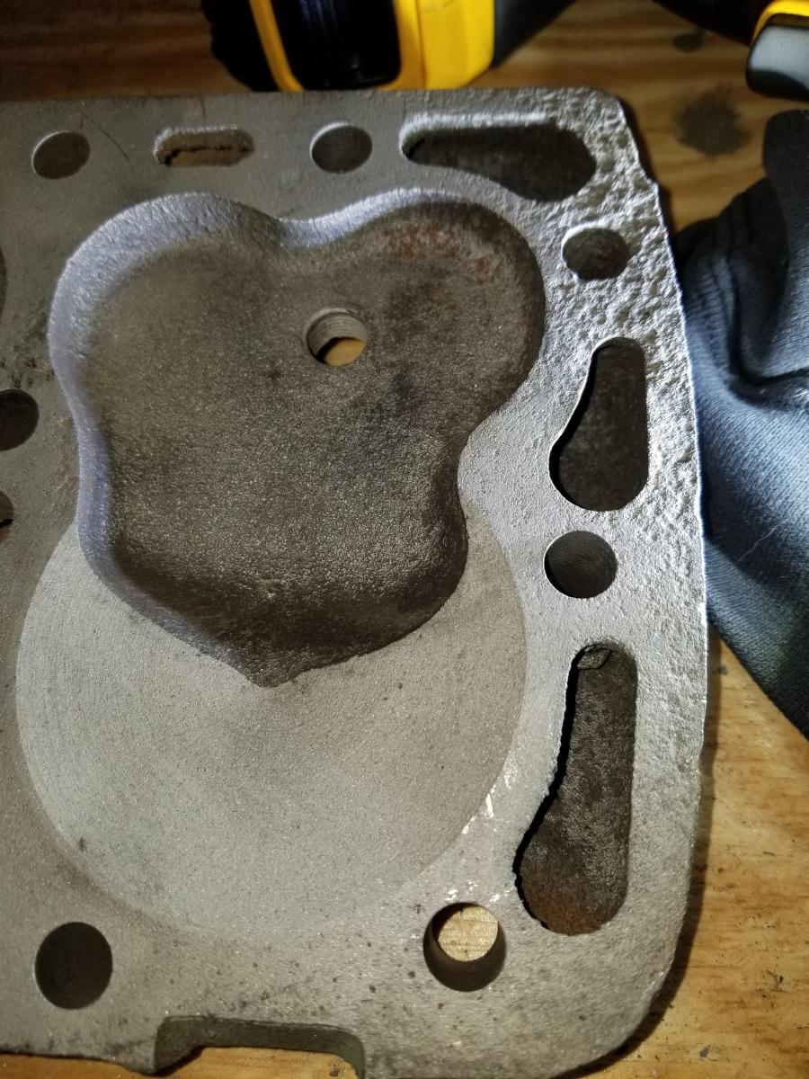

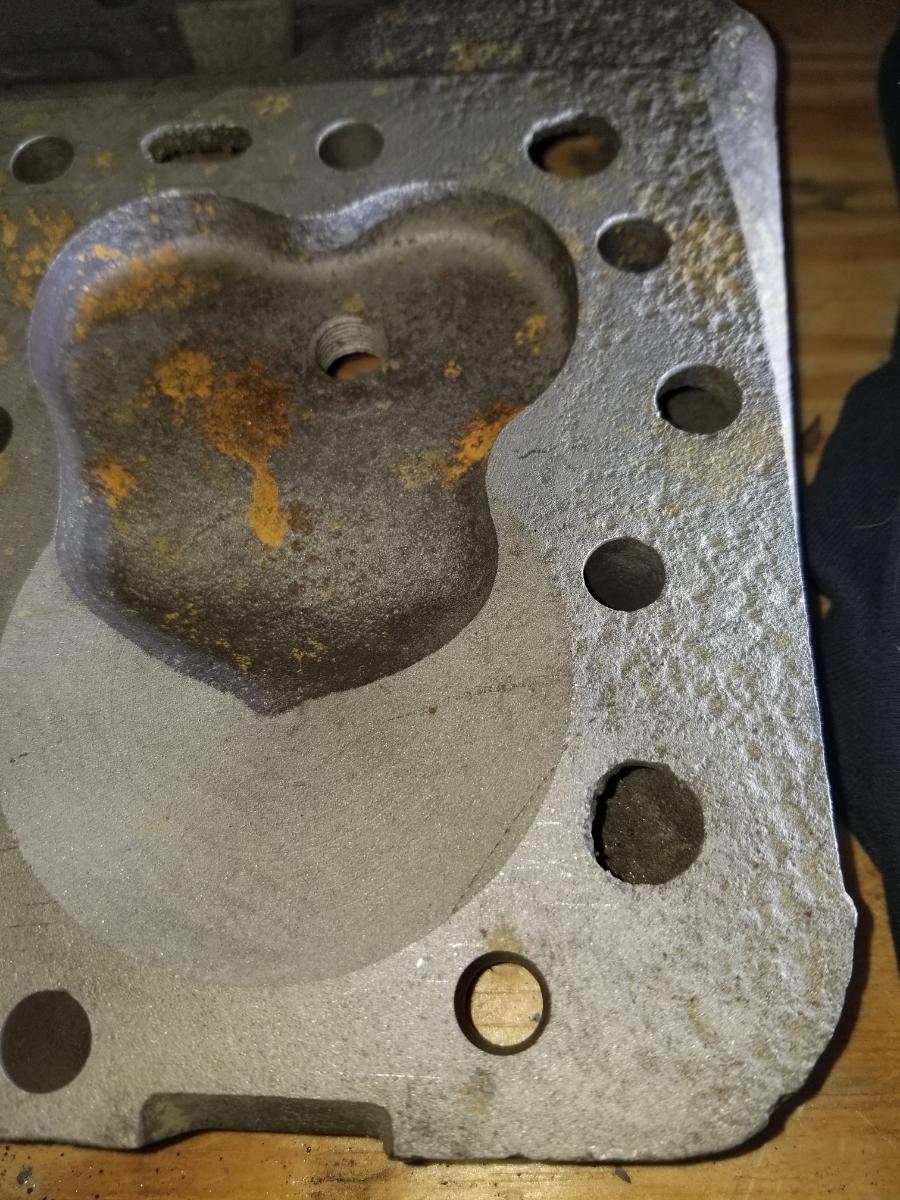

I'm doing a frame off restoration on the truck. When I bought it two years ago it had a blue 8BA engine. I read on the Van Pelt site the original engines were red and had 8RT cast into the heads so I'm pretty sure the engine was swapped out of a car at some point. The 8BA heads were cracked so I found a pair of 8RT heads online but from what I can tell the 8RTs look badly pitted near the ends . Is it possible to repair the pitting on the 8RT heads? Who does such work? Or if repair is not an option, what would be the best option for new replacement heads of some kind. I'd like to stay original, but if I can't I can't. This message was edited by glenn_2718 on 8-4-23 @ 1:12 PM

Original Kilroy | -- 08-04-2023 @ 5:17 PM |
Thats some pretty severe pitting around the water port on the last photo. Back in the day ,I would say you were out of luck But today I would seek out a quality welder and see what thay say and hopefully if they're confident they can build up the pits, I would seek out the same quality of machine shop to surface the heads.After the repairs I would use a light coating of aviation cement in and around any divits left over .
