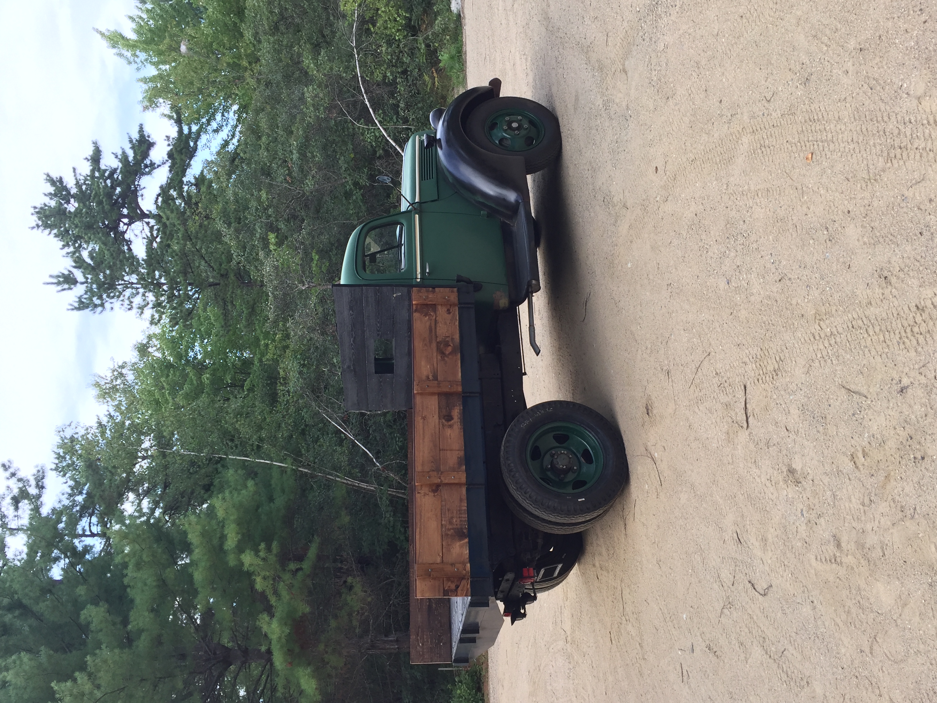

I have a 1940 dump truck with a V8 95. Truck runs great . My question is did they have oil filters on commercial trucks and if so where should it be located. Thanks
