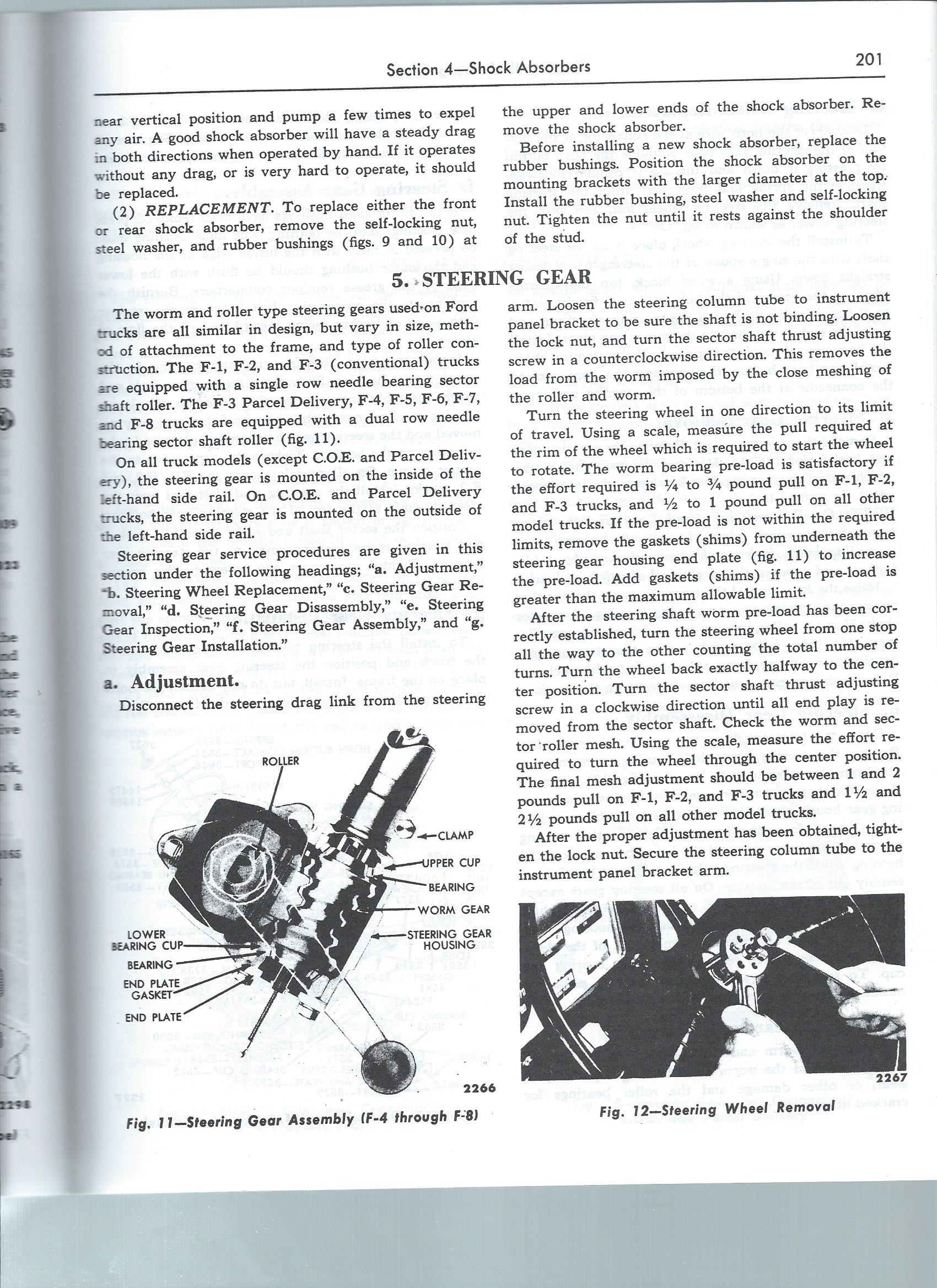

Thanks for your help. I tested both front wheels as you suggested, and they are in good shape as to wobble in the wheel. So I would appreciate your additional input as to how to adjust the steering gear to take some of the play out of the steering. Thank you again.
51f1 | -- 05-26-2017 @ 3:24 PM |
Sounds like you need a Ford shop manual for 49-52 trucks. Reproductions are available from the usual old Ford parts suppliers. I have attached a page from the repair manual that covers adjusting the steering gear. My experience has been that the looseness in the steering doesn't usually occur in the steering gear, but that's just my experience. There is a lot more looseness in the old steering when its new than what we are used to with modern cars and trucks. Richard
TomO | -- 05-27-2017 @ 6:54 AM |
Thanks for posting the instructions, Richard. I agree that loose steering usually has other causes and that if you have to adjust the gear, you probably have excess wear in the steering box and it should be rebuilt. Tom
