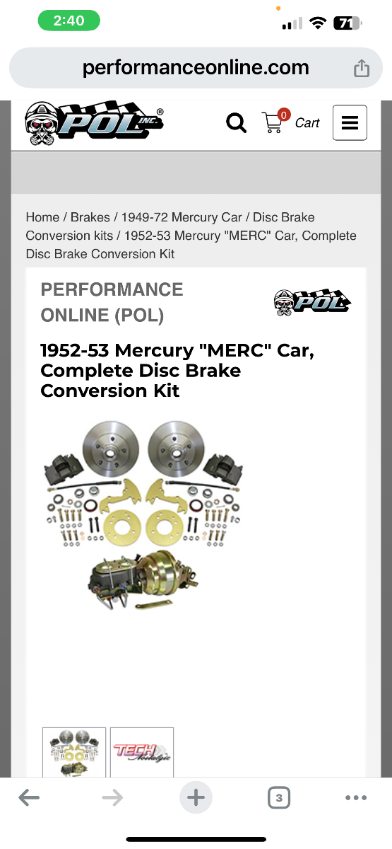

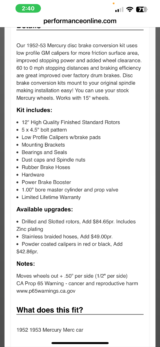

dean333    -- 12-20-2024 @ 12:18 PM
  CPP does not have a kit. Yogi’s doesn’t have the booster. POL has a complete kit less the lines. Thanks.
