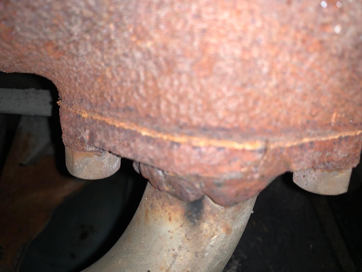

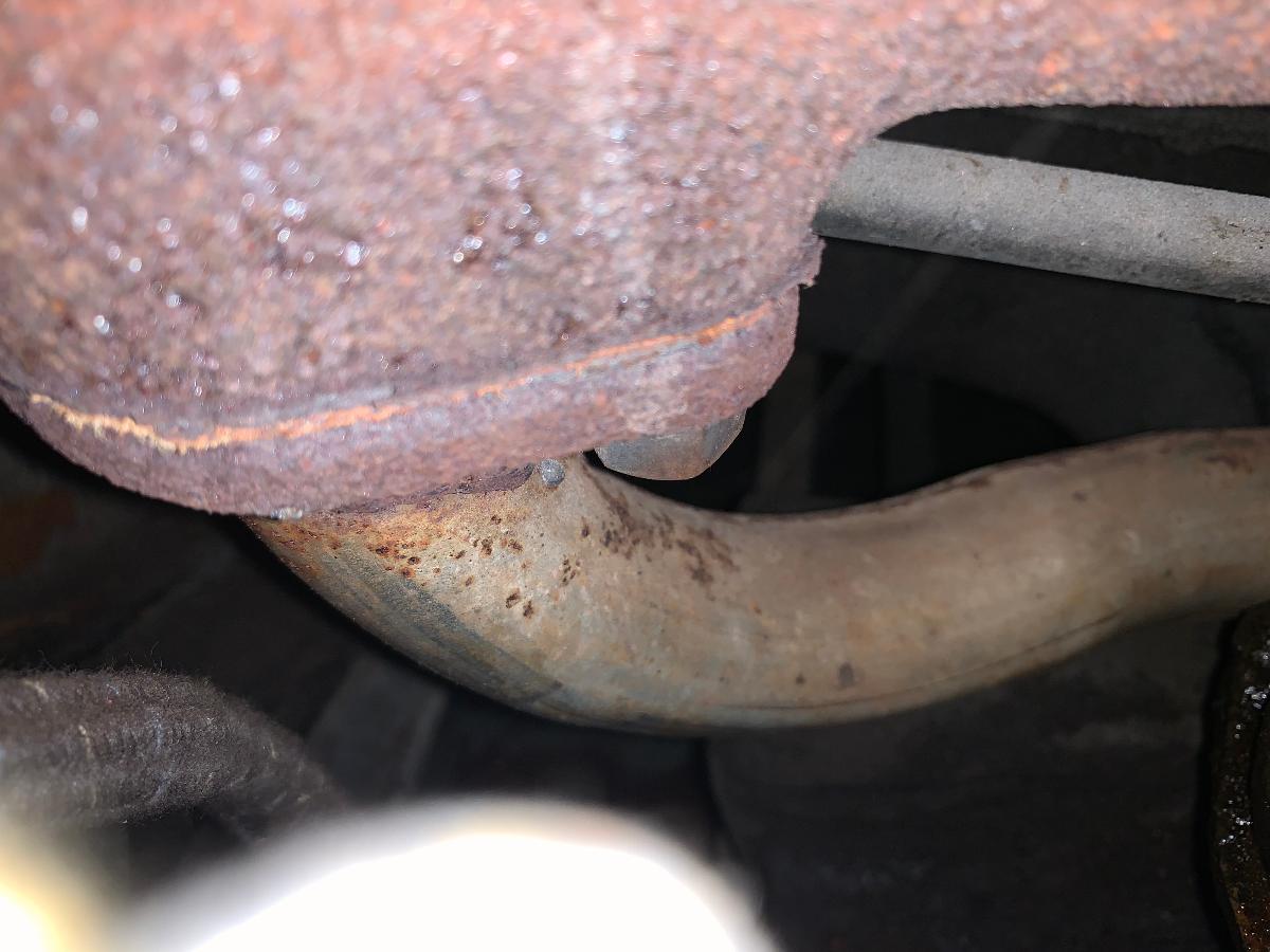

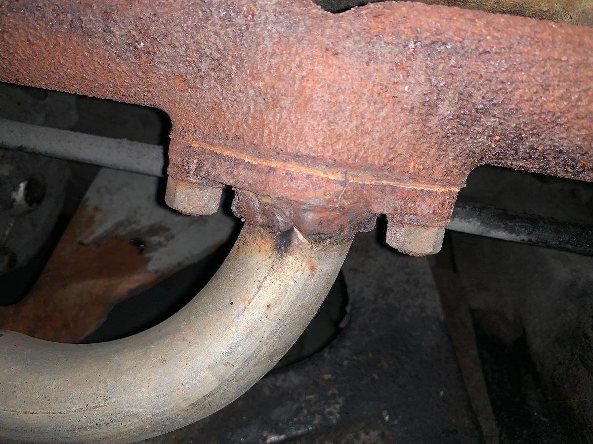

I took some images of my Rh and Lh exhaust manifolds specifically where the Muffler shop welded the pipes to the flange. I appears the Rh side shows some evidence of a small leak?
TomO | -- 05-25-2021 @ 8:41 PM |
That could be the source of your noise, put your hand carefully near the pipe and have an assistant rev the engine. You should feel exhaust gasses if that is leaking Tom

sarahcecelia | -- 05-28-2021 @ 4:44 AM |
Whomever did that welding did a very poor job! That is your problem with the "ticking." Good welding is not a series of "blobs; it is a series of overlapping welds all in a row." Go to a good pro welding shop and look at some of their welds- You'll see what I'm talking about! Regards, Steve Lee
sarahcecelia | -- 05-28-2021 @ 4:48 AM |
Those welds are terrible! Go to a pro welding shop and look at their welds! Regards, Steve Lee
39mercury | -- 06-03-2021 @ 7:03 PM |
Thanks for your honesty Steve! Those welds are bad. I think that since I’m driving it more often I am noticing what still needs fixed. I have a friend lined up to fix them. I also noticed the oil was down a quart when I drove it last week so maybe the oil I added will also help.
