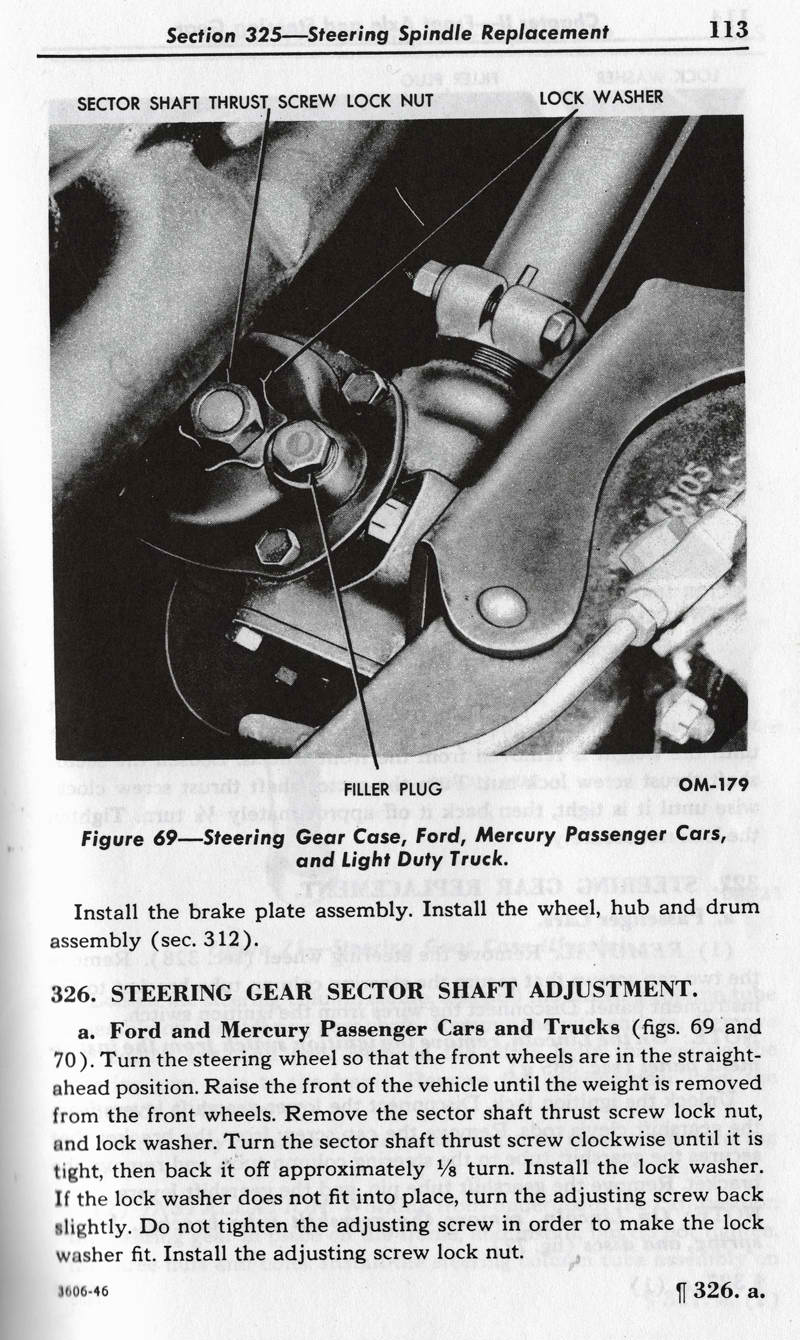

Ken, The steering gears '39 - '40 are identical. The adjustment procedure is quite easy. I like to have the weight off the front wheels. Turn the steering wheel in to the center of its travel. Atop the steering gear you will notice a washer that appears a bit like a star. Remove the nut (cap) above that washer and remove the washer. Now exposed you will easily notice a slot at the end of the adjustment screw. Turn it in to tighten the gear load. Usually it won't take much, maybe 30° or so. Replace the washer and nut and check the feel at the steering wheel. If it feels too tight, back off the adjustment a bit. If the worm & sector are worn out, no amount of adjustment will remedy that issue.

Attached is another procedure, either should work.
