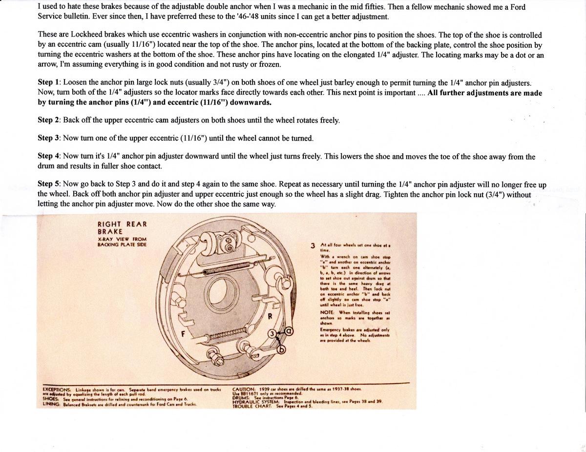

This might help ______________ No signature

Ok, I tightend the top front shoe at top to were wheel will not turn then I go to bottom adjustment where the dots are facing each other and start tightening until wheel will move.This should center shoe correct?Some I am getting this movement but most are not?What am I doing wrong here or is some of the shoes not fitting the drum correctly?New shoes,wheel cylinders from DC.Just guessing maybe my drums are worn past limits?
