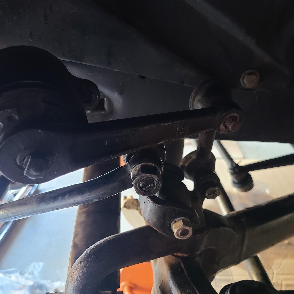

All good but unable to determine how to best remove links at end of shock arm. Not a good pic, shock arm is connected to pivot, removed nut but unable to get the shaft out of link. Hope this makes sense. TIA

I use a tie rod end "press" tool. It's small, about $25 from Napa and works perfectly. Unlike a "pickle fork", it won't damage anything. Mike "Kube" Kubarth

Kube, I went to NAPA for the tool you described, they had no clue. Could you give us a part number or picture. It sounds like a tool that several V8 members should have. Thanks, Jim Snyder

Got mine at AutoZone on their tool loan program. $35 to buy. This message was edited by 40cabriolettony on 10-26-22 @ 8:56 PM

Jim, Whomever you spoke with at your local Napa is well, not very sharp. These tools have been around longer than I have. Here is just one of many listed-on Amazon. https://www.amazon.com/Performance-Tool-W83025-Tie-Puller/dp/B002NE0UPQ?th=1 Mike "Kube" Kubarth
