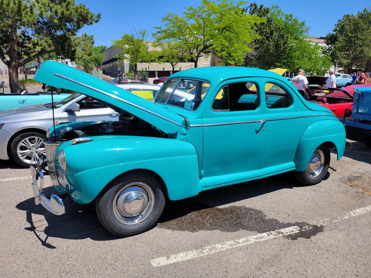

41 Ford Super Deluxe Coupe, has a vibration above 35mph, does not go away much when I press in on the clutch, feels faster and harder than a wheel out of balance. Gets worse if accelerating. Engine seems to Rev fine and smooth, any ideas? Also Tranny and clutch are rebuilt a few months ago and the vibration was there before. Thanks alot! This message was edited by my41 on 7-15-22 @ 8:27 PM
