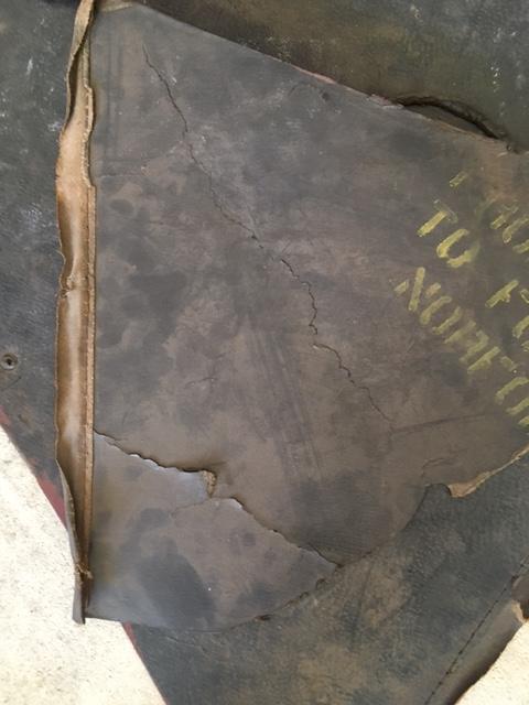

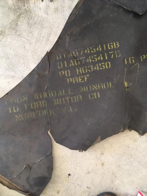

fortyford | -- 04-03-2022 @ 8:31 AM |
Can someone explain to me what the stitched edging is for on the coupe trunk side panel?Yep it is stenciled on the back side!Are there any photos out there on how the panels in front of trunk is suppose to look?These came from an Opera Coupe which I have also. This message was edited by fortyford on 4-6-22 @ 7:46 AM
