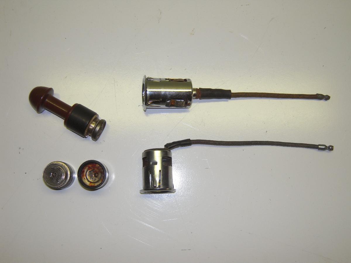

kubes40 | -- 01-18-2021 @ 11:14 AM |
Well, yes, kind of... the receptacle for radio equipped cars is much shorter than non-radio cars. It is true the wire comes off the back of the receptacle at a 90° bend. Picture attached of concourse correct pieces for 1940 Ford passenger cars. Mike "Kube" Kubarth
