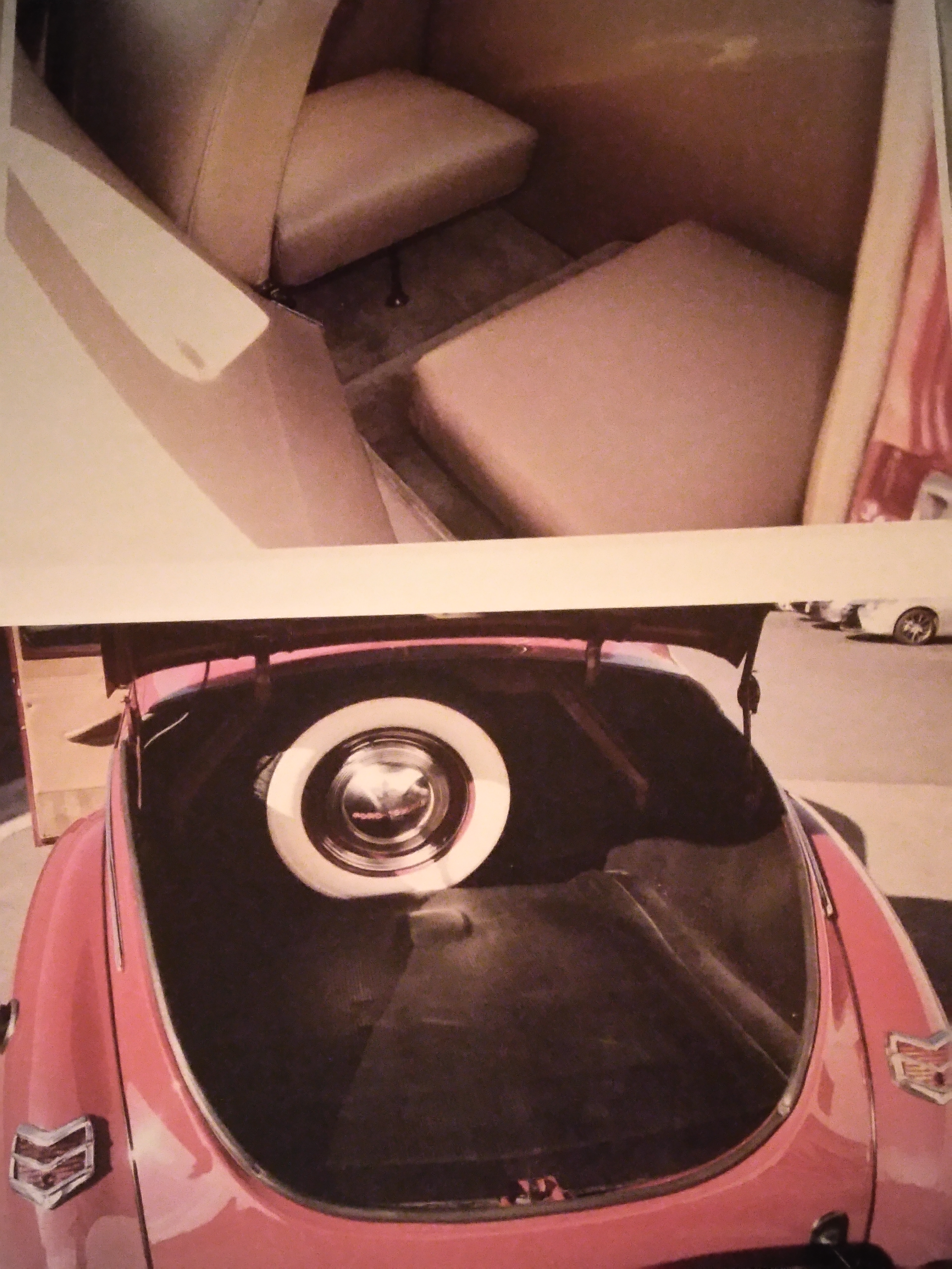

Here is a couple of pictures of a '40 coupe. Noticed the truck pan picture, it clearly shows the trunk floor extending six inches forward beyond the rear end hump before it drops down, and the spare tire bracing arms go out to the wheel wells. This trunk pan lay out is exactly the same as my 1940 five window coupe. Now look at the interior picture it clearly shows the rear jump seats are basically touching the back of the split bench seat. I believe that this car is a five window coupe, not a business coupe, with just the jump seats and the split bench front seat added. Domenic This message was edited by thunder road on 1-7-18 @ 4:40 AM
