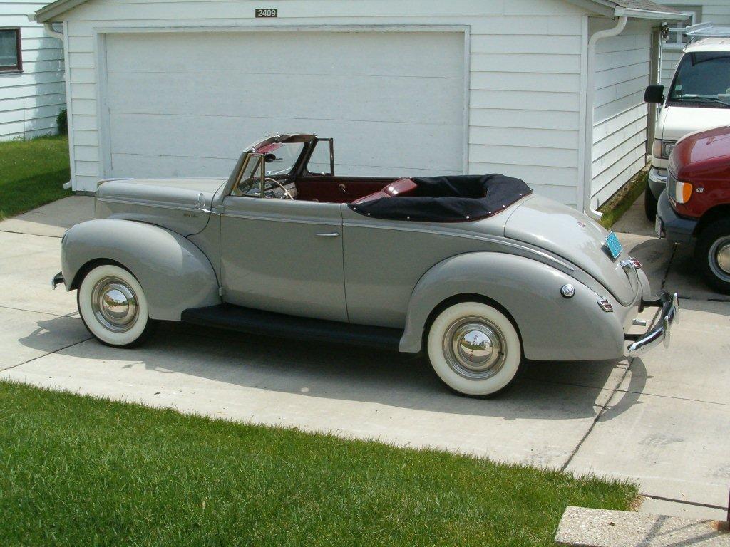

I gave you a bit of misinformation earlier. There are actually nine snaps along the back body rail. Picture attached that I hope will help. There are of course more at the "banana clips" but the number depends on if you have the early or late design clips. If memory serves there are five along the top of the rear back rest. Or is it three? Perhaps someone can jump in here... Mike "Kube" Kubarth
shogun1940 | -- 05-29-2017 @ 5:18 AM |

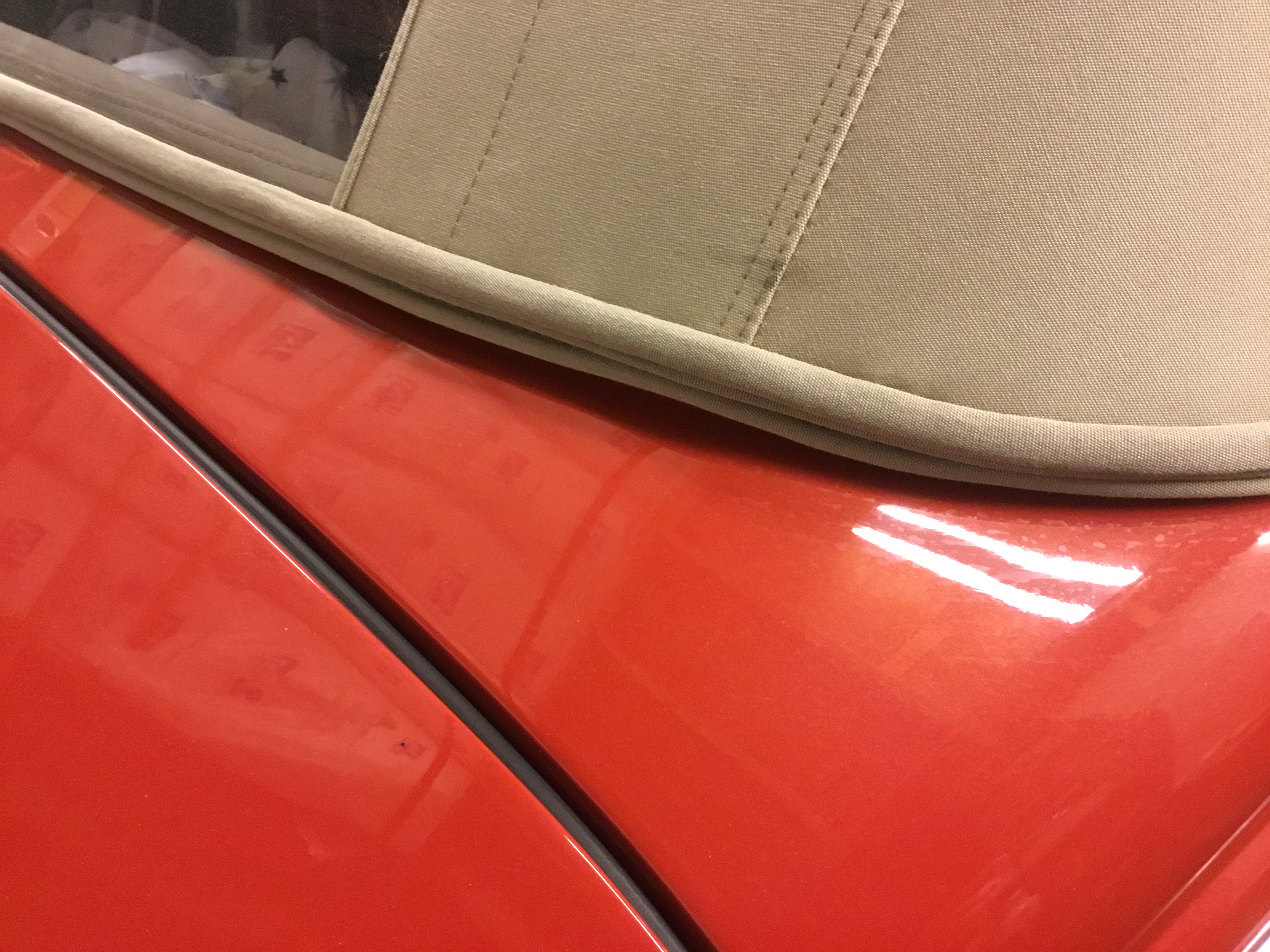

That is a beautiful car,, where i have to put the male part of the snaps through the the cloth and beading is round do you just flatten it.
kubes40 | -- 05-29-2017 @ 6:31 AM |
Yes, you just flatten it. Drawing down of the male snap will do this naturally. Mike "Kube" Kubarth
