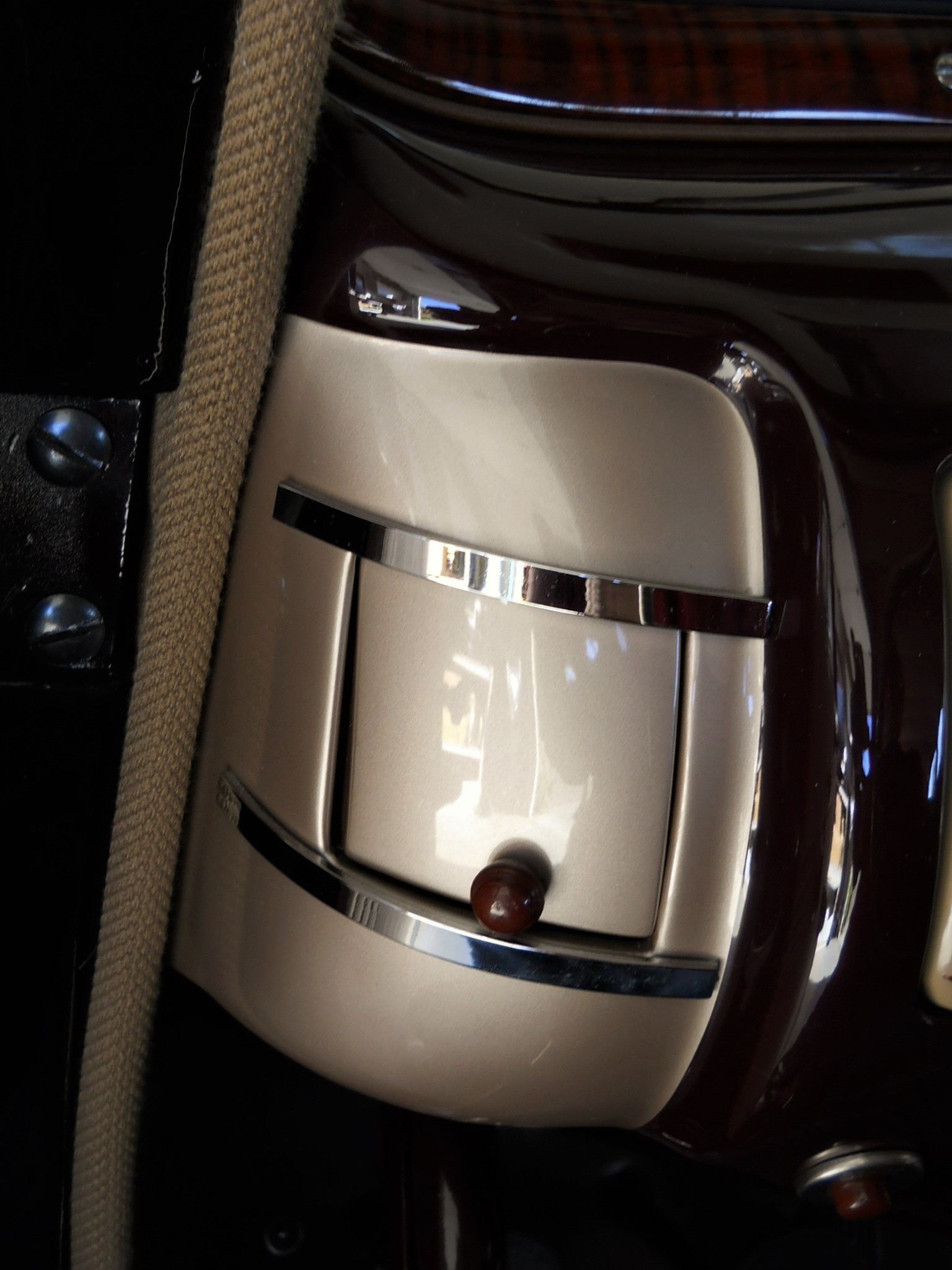

Good Morning, Domenic--- Just a very general observation on your "early" vs "late" Ford question. How do the ashtrays open? Do you have a little door, with the knob at the bottom, and you push it in and slide it up to open it? Or, are they hinged at the bottom, and you pull the knob at the top to open it? As a GENERAL RULE OF THUMB (and Mike can help you more with this), the sliding door style indicates an "early" model (made in the Fall of 1939) and the ashtrays became hinged after approximately January, 1940, which would make them "late" models. See attached photo of the driver's side ashtray in my Deluxe 4 dr. Sedan. It shows the slide up door. I have confirmed that the car was assembled in September, 1939, so definitely - an "early" model. Good Luck. Tom P.S. - I was born in Mt. Vernon, N.Y. and raised in Westbury, Long Island, so I remember the salted roads. No fun.

Hey Tom, thank you for the great info, on the early cars having slide up doors for the ash tray's and the wiper motor bracket spot welded, or bolted. Mt. Vernon N.Y. is about 20 miles south of me. I used to take my first 40 ford coupe to the Mamaroneck car show in Sept. Back then the completion their was fierce . It took me at least three or four try's before I won a first place their. Me and my friend would take notes at Hershey and keep trying to detail and make our cars more correct. The guy I sold my first 40 coupe to lives in Mamaroneck and still owns it . It took me a total of twelve years from the first time I saw it to save up for it, and restore it, before I could drive the car it's first mile. I can't wait now to go out and check out my ash trays, and my wiper motor mounting bracket! Dom Domenic This message was edited by thunder road on 3-27-17 @ 5:16 PM
