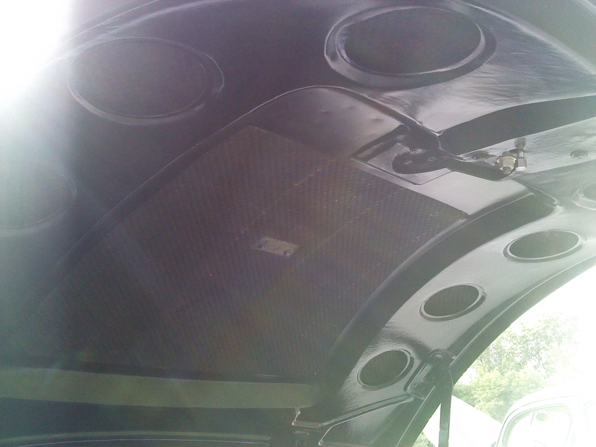

40 Coupe | -- 03-28-2017 @ 5:17 AM |
Just in case your interested this is the interior of an early 40 coupe trunk lid.
kubes40 | -- 03-28-2017 @ 8:12 AM |
That's a picture of a '39 trunk lid. It is possible a few of these were installed on '40 Fords but that would have been in August of 1939, perhaps, PERHAPS, in to September.
thunder road | -- 03-28-2017 @ 8:36 PM |
In this picture of the inside of the 1939 coupe trunk lid you can clearly see the saturated felt , adhered to the middle section. This I\4 inch heavy sound deadening ,tar paper was used in various locations . Are these locations possibly going to be portrayed in the new book? Also the correct location of the Ford script / date code/ etching for the glass? Domenic
ronford | -- 03-28-2017 @ 9:43 PM |
I have a very very original 40 Deluxe Coupe with 11/39 and 12/39 dated glass that has 39 style inner structure to the trunk lid. The lid appears original to the car and is like the 40 lid shown in the photo previously posted.
